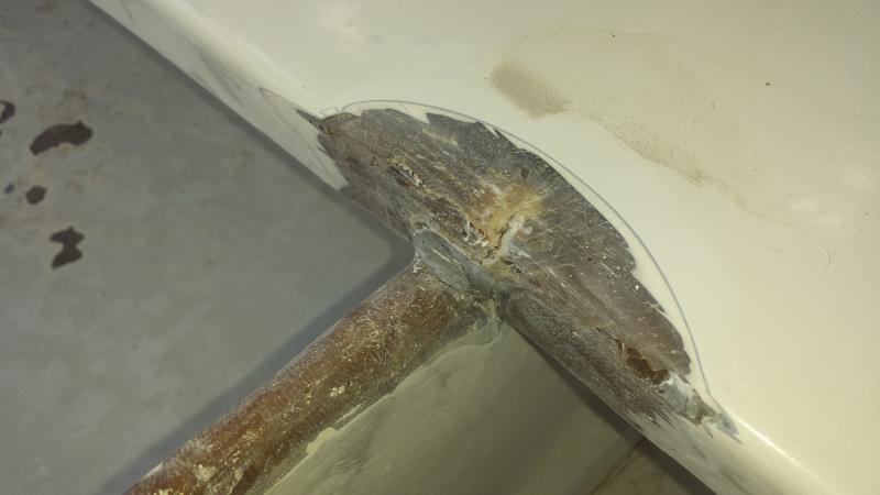

First, let me say I do not have a Widgeon. I have the smaller Sprite, but I did just finish some repairs to the laminate on my interior bottom. I also fixed a crack somewhat like yours where my athwartship seat amidships attaches to the centerboard trunk. I used epoxy and fiberglass cloth to reconstruct the joint. I have also used starboard marine "lumber" to replace fiberglass seating in the stern of my boat that became problematic. In addition, I used starboard as the transom support that was originally marine plywood. There are issues with starboard and sealants, but it does bolt on very well. I was picturing a fiberglass/epoxy repair to your mast opening with a circular starboard brace underneath bolted through the deck. Again, not familiar with the Widgeon, but very familiar with flawed fiberglass! I will encourage you to explore options and experiment with new skills and knowledge. I was very hesitant, but I learned to use the folks on the forum and the telephone numbers on products to get good expert advice. West System folks were outstanding, as were the folks at Interlux and Pettit.:)
