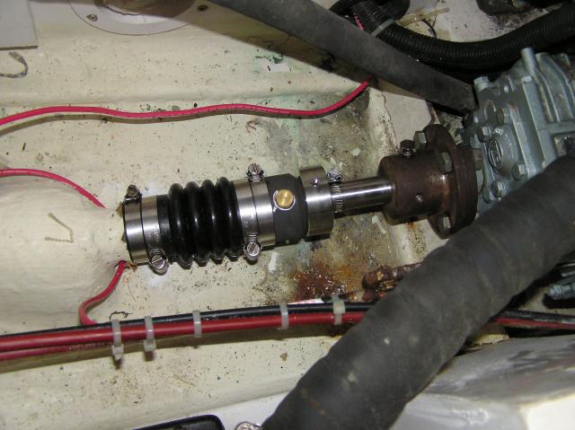

If your shaft is anything like the one on my 310 and the one I ordered from Catalina for my C-36 it was a light tap or press fit from the factory. I pulled my C-310 shaft after only a few moths to install a PSS and the fit was quite tight. I still had it checked for fit and face and the coupling was within spec to re-use it. This has been the only coupling I have come across that was reusable and within spec when checked because it had not yet had enough time to form much of a layer of rust.
From my train of thought fitting and facing a new coupling, or even just paying to have it checked, is cheaper than a whole new shaft if it happens to get ruined from a sloppy fit..
