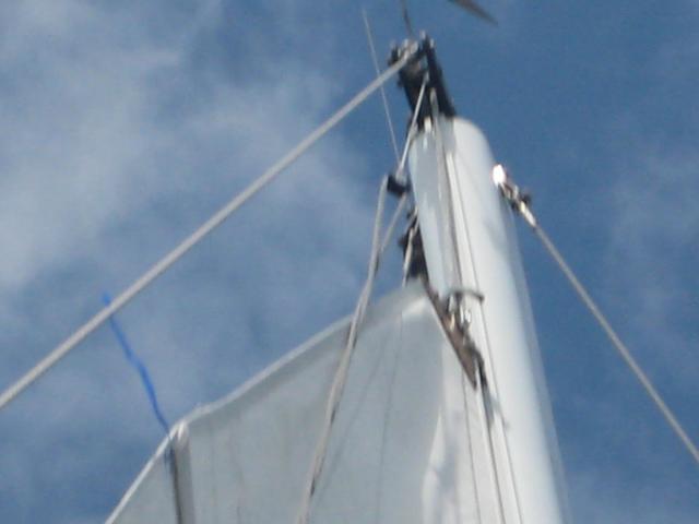

I'm around 5-8 and my boom hits me about an inch above my ear...so sounds like our booms are in about the same place. My main also does not go all the way to the top of the mast (see pic). I was once told to have the sail measured and make sure the bolt rope hasn't shrunk.

From the small image it looks to me as if you need to let out the main sheet, vang and outhaul, then finish raising the main sail.
The leech is very tight yet the luff is loose and sloppy, a sure sign the vang or main sheet were pre-loaded before hoisting the main..
Another thing I noticed, and it may just be an illusion, but after saving the image to my computer, and blowing it up as much as I could, it really looks like you are using a jib or spin halyard to hoist the main and it appears to be wrapping the top of the mast which would also prevent a full hoist..?
If you send me the full size image, straight out of the camera, I can tweak it and zoom it to confirm this, or not, for you.

I'm going with the optical illusion theory on the halyard...the pic shows things up closer. you might have been seeing that twisted up dutchman control line, since replaced. That right there is as high up the mast I can crank it. You are right tho...I have a bad habit of raising the main with a loaded up mainsheet and a tight outhaul.
