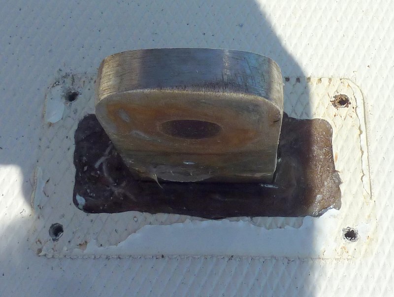

I rebedded this chain plate recently and found it to the a perfect example of just why silicone, can be such a bad choice of product for some applications.:doh:
The owner of this boat potted all his chain plates sealing the surrounding core from moisture, a real +1 !! He then proceeded to bed them with silicone a -100......Doh'...... They then leaked pretty quickly. He then judiciously cleaned the surfaces of what he assumed was all the silicone, using multiple chemicals such as Acetone, MEK and Toluene, and re-bedded but......

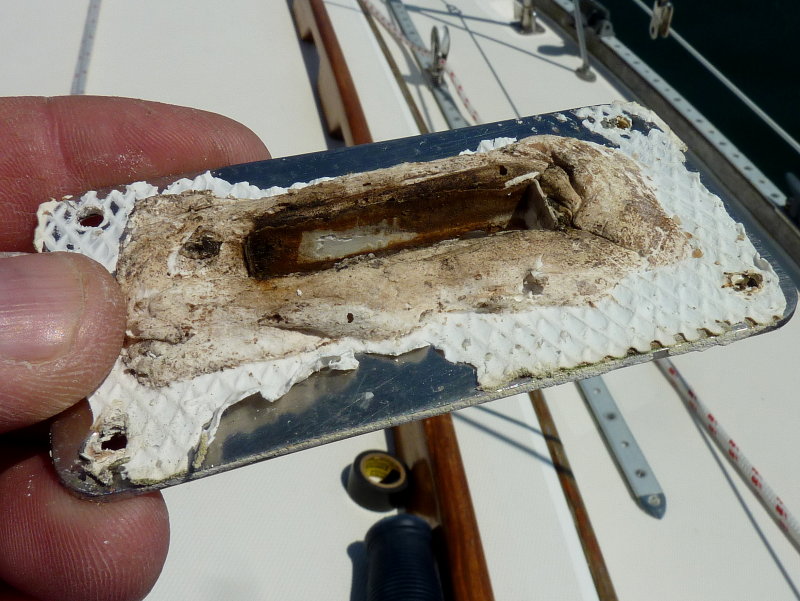

This is how the cover plate came off after being bedded with a "polyurethane marine sealant"... One small area of adhesion and the rest was stuck like an egg in a non-stick frying pan.
And how the cover plate came off... The brownish color is mold & mildew from water sitting in there. The new sealant stuck to NOTHING due to the contamination from the previous bedding job.. Trust me, if you THINK you got all the silicone, think again....
Just this one chain plate took nearly an hour with grinders, ScotchBrite, sand paper, a Dremel and lots of Acetone to get it clean enough to re-bed.
Please think of these photo BEFORE you bed stuff on your boat...;)

I do note in the photos that the stainless to silicone bond is much better than the bond to the fiberglass. Makes me think that the mold release or wax layer was not properly removed. This will effect the adhesion ability of any sealant (even the right one).

That bit of clear silicone was added after it leaked, as a Band-Aid. It was added above the cover plate in a last ditch attempt to try and minimize the leak. This was done after he had re-bedded it and cleaned it after the first leaking silicone job which had been a white silicone, not clear. The original install was de-waxed and cleaned before sealing as confirmed by the owner.. I clean amine blush all the time and never have an issue with it. This contamination was much more severe.

So I've spent the last few days on my hands and knees working on my chainplates. Removed the chainplates, cleaned, dye-penetrant tested, routed out and filled the core, the works. I've become quite "intimate" with this part of my boat. And, based upon nothing more than that 6" square photograph, I'm wiling to bet a beer (maybe even some rum!) that this is a picture of a Sabre. Mine is a '79 S34.

Bingo..!
