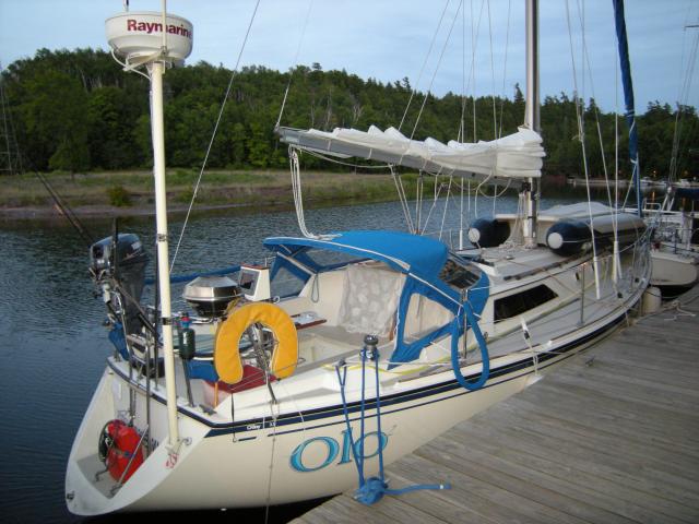

May 27, 2004
933
Beneteau 393 Bayfield, Wi
We have an oversized dinghy compared to most out there (11' 6" inflatable w/ 9.9 four stroke) and we occasionally pull it on deck when sailing out of the protected cruising grounds. We use the boom and attach the boom vang to the end of the boom to lift the engine. It works very well. I hang the motor on the inside of the pushpit which takes some of the stress off as opposed to hanging it off the back.
With the motor removed, I attach the whisker pole to the mast and run the spinnaker halyard through the end of the pole, then down to the dinghy and lift it from the towing bridal. The pole acts like a crane that keeps the dinghy away from the boat and it helps guide the dinghy on to the boat. It works slick but it's not fast. Start to finish, it's about 20 minutes worth of work but as I said, we do this only when heading into open water.
