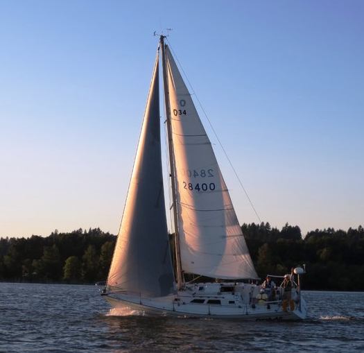

Here's a pix of us from a couple of weeks ago, courtesy of a friend who by chance was out for a sail and had a camera with him. That is a 95% jib, sheeted just inside the shrouds. Doin' about 7 kts to weather in about 12 kts of breeze.
Note that the main is not on center, but down just a bit to balance the helm.
This week we got 'er up to 7.3 kts in 17 kts of wind with that jib and one reef in the main.
The vertical battens make a huge difference in a tall narrow jib like this. Wish I had thought of this a decade ago!
