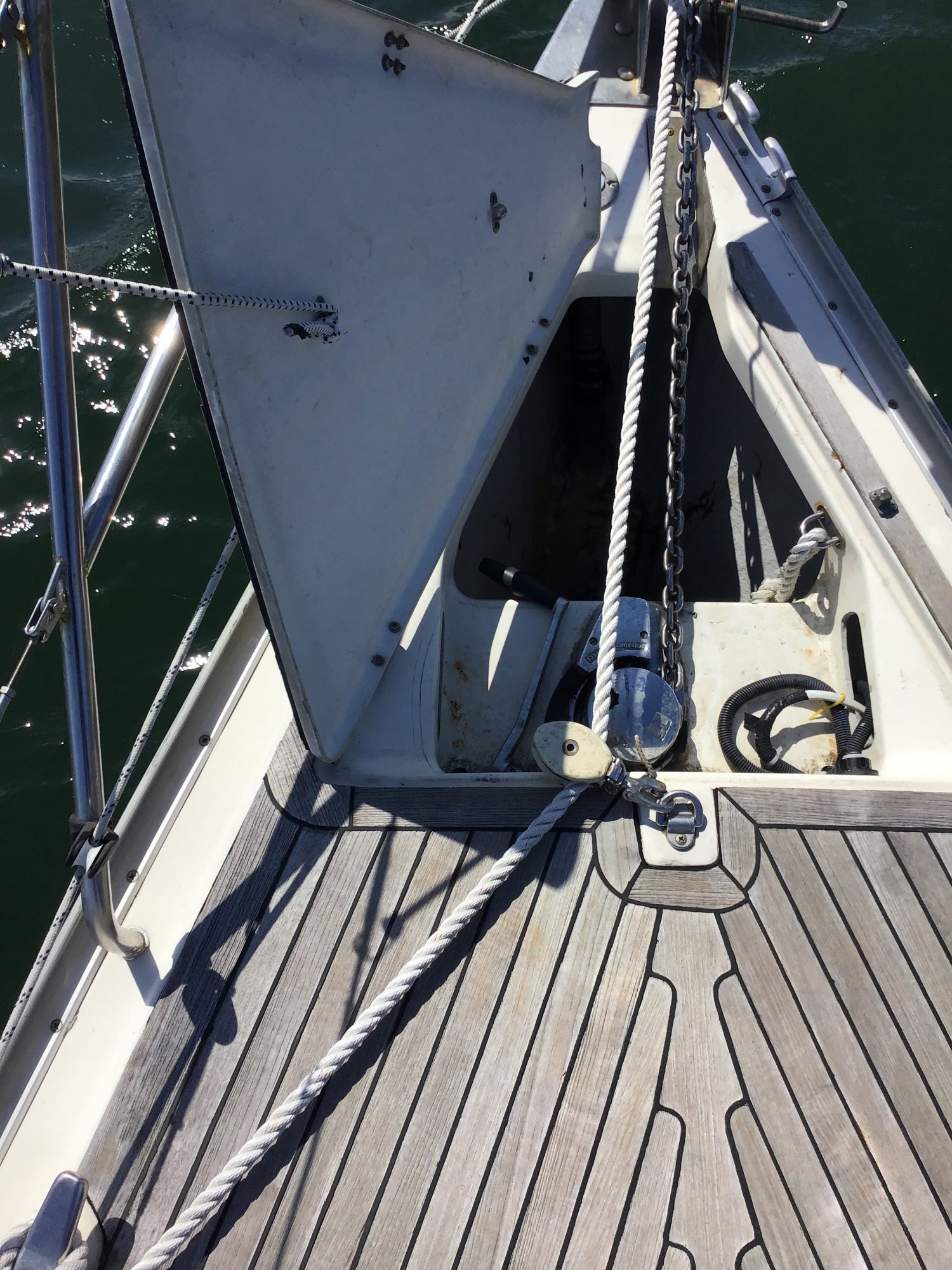

Bridle-rigged snubbers make sense when used on beamy powerboats that are wide near the bow, and on catamarans. But they make no sense to me when used on monohulls of comparatively narrow bows. They are no better there than single line snubbers in preventing “hunting” at anchor. They are much slower to rig and deploy than a single line. A single line is sufficient to hold the boat in strong wind because the “weak link” in anchoring is typically the anchor size and set not snubber (rope) strength.
I attach mine with a chain hook and run it out with the chain rode over the bow roller down to water’s surface. Stop it off at one the bow cleat. The hook easily drops off when the line is slacked so I can pull it in, and then recover (windlass) the chain and get underway. Very quick job.
I see many sailboaters with bridles bent over the bow detaching the assembly while recovering. Very slow. They all look very nautical, but what is the bridled snubber doing on a sailboat at anchor that a single line snubber cannot?

The one main advantage I see is distributing the anchor load to 2 cleats instead of one. There may also be some small advantage to having the boat lie directly into the wind as opposed to a slight angle.
With that said, I use a single snubber unless I'm on a moor that requires two lines. The snubber uses a homemade version of the Mantus Snubber Pendant. It is not as easy to engage or disengage as a hook, however it is more secure that a single chain hook and causes no wear on the anchor. It is also multipurpose, as it can be used to take the load off a line as might be necessary if there is a winch override.

I doubt the bridled boat will align to the wind more than one with a single line where, as I describe, the snubber line is veered with the chain over the bow roller, so therefore rests directly ahead of the boat. The chain is not being hooked after passing over the roller, with the line then being led through a bow chock to a cleat, which would put the boat unaligned with the wind.
Also, you could hitch a second line to the snubber line at some point aft of the roller assembly and then lead to the other cleat. Form a “Y”, thereby spreading the load between two cleats although the one line bears the full load going forward. I do this occasionally. IMO, the chain hook is very secure. Mine does not fall off when the point of its attachment to chain is under load. If the chain goes slack, its drooping weight is enough to keep the hook attached. Only when I slack the snubber line itself will the hook fall off. That can happen as I start to winch in the chain; i.e., the load is transferred to the windlass, so the snubber is slacked and the hook may fall off if it is not on the top side of the chain. But that’s what you wish, to detach the snubber.

So we evidently agree. My snubber length runs maybe 25 ft from the cleat so should not reach the bottom as I anchor in greater than 15 ft. If the chain goes slack, the hook would not touch. I’ve solved the other problems you mention. The snubber is led through a snatch block attached to a strong point in line with the roller assembly. If I had no strong point there, I could make the “Y” at the at the snatch block by attaching it to a line with eye splice leading to the starboard cleat and stopped. That line could be one of those short WM dock lines if you aren’t good at splicing.

While I typically only use a single "snubber line" with my anchor, I have found sometimes using two, one from each forward cleat, can help the boat from sailing back and forth. It's not common, but I have had a couple places where the wind, wave and tides make using the double connection to "pacify" the motion advantageous.
I don't actually use a "snubber" (those rubber shock absorbers), I use nylon three braid line. I also don't use a hook as they can come off. I use a dyneema line wrapped with chafe protection wrapped around the chain that comes into a shackle - can't come off. It is a pain to set and retrieve so I only do it when conditions merit the added work to set and retrieve. I will attach both lines to the shackle.
