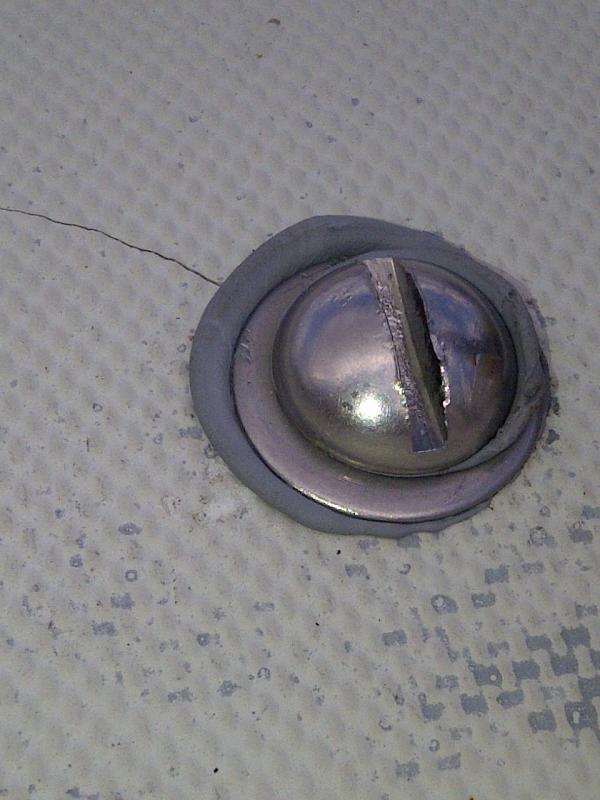

Heck I have even had people send me stuff that was sold as "butyl tape" that was not even close to butyl tape and more like plumbers putty on a roll.... One guy even had his "butyl tape" wash out from between the deck and fitting over a few month period. These cases were not as rare as one might think.

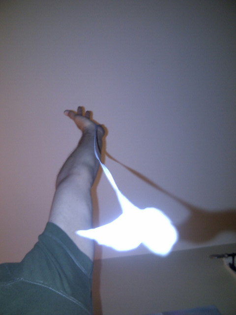

When you find a tape it should not come off on your fingers when working with it. A simple 1" or 2" piece should be able to slowly stretch many feet without fracturing. It should be dense and very uniform in extrusion. High quality tapes extrude cleaner. On-line I found you often can't go by pictures because what they show may not even be close to what they ship you. Even some manufactuers selling a butyl putty tape leave out the "putty" part of the description..
