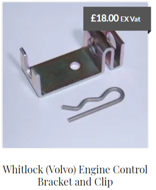

In case it cracks again or if somebody else needs this part, you can google the following "Retainer 853423" or in Swedish "Hållare 853423". It is a Volvo part that most dealers probably can get unless you buy it directly over the web. I found it in one picture with #11 in attached picture. However do the search otherwise! E.g. Volvo Penta - Control cable retainer bracket - Top Mount - Side mount - 853423
