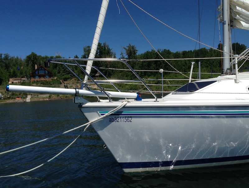

I have a whisker pole on my present sailboat and also my past sailboat. In those 13 years I think I used them one time each. The conditions have to be just right for you to be able to utilize it. They do look very salty when they are mounted to your stancions though. Just my .02 worth.

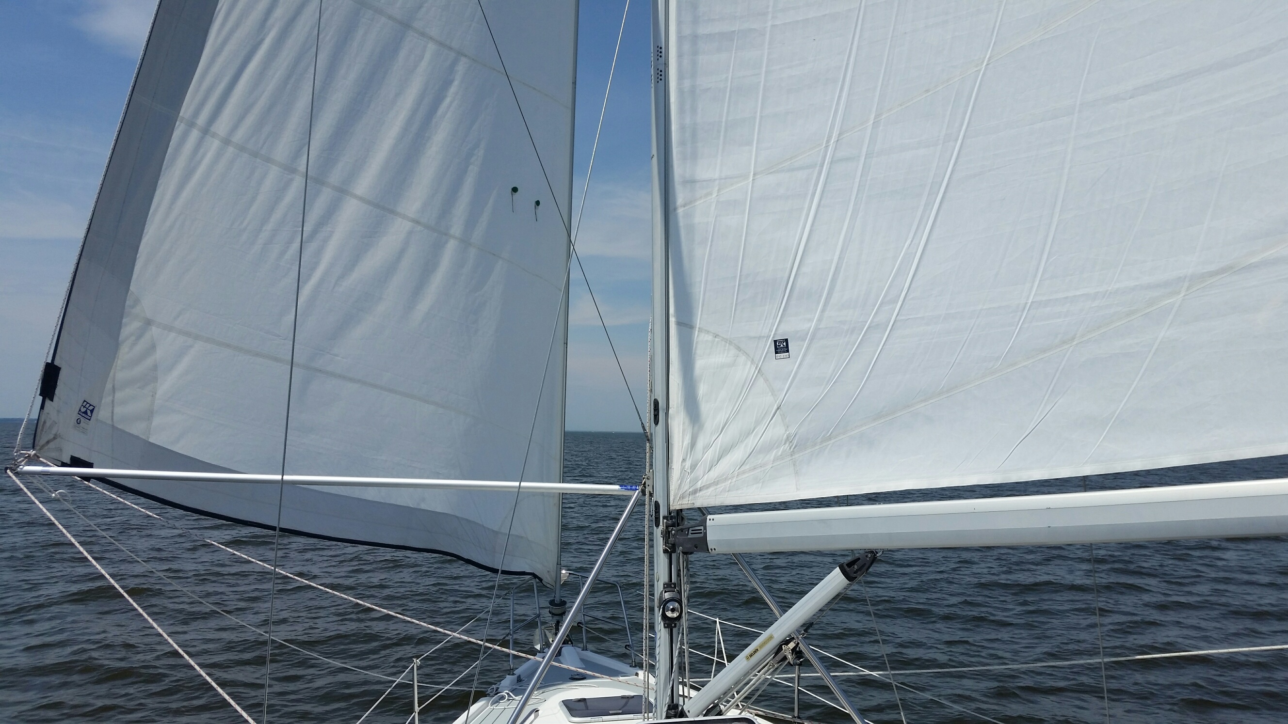

The whisker pole got replaced by something far more functional.
Hafa
Jan 24, 2017
28
Hunter 40.5 Saipan
*Edit: A sprite/spinaker would be nice. Maybe someday. I'd still keep my whisker pole; a bit less effort to deploy/retrieve, especially with a furling jib.
For the OP, +1 for the telescoping pole. For downwind reaches, a properly deployed whisker pole with a genoa will add noticeably to your speed. Coupled with a proper preventer, it makes for effortless and fast downwind runs and is very easy to deploy and retrieve when proper procedures are followed.
Jun 11, 2011
1,243
Hunter 41 Lewes
Nice Sprite Meriachee. BC I believe Scott is right, according to the US sailing rules the whisker pole may equal your LP. If you don't race it's a mute point but should be close to your LP. The LP is a diagonal line from the clew of the jib to the center of it's luff. I like a whisker pole. It stops the jib from fluttering and collapsing. Although an Asym on a sprite is more fun.
