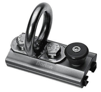

I was out yesterday in very light winds and tried my asymmetrical spinnaker (a Doyle sail from my previous boat), it worked alright but at times we really needed a whisker pole. I have a 2" Forespar whisker pole but do not have a ring to mount it on the front of my mast. Looking at the local chandlery and also at Defender I don't see anything that looks like it is made to fit the curved front surface on a 260 mast. Does Hunter supply one as an option and if so does anyone know the make & model ?
thanks Bob

The ring on mine is attached (welded) to a track car. So you can adjust the height of the pole. The track is riveted to the front of the mass.

I had a track on my last boat but was trying to simplify things on this one and just have a ring mounted on the front of the mast, maybe just in front of the gooseneck ?

When I mounted my mast ring, I first wrapped the mast with plastic wrap, mixed up some thick epoxy, and clamped the mast ring on the mast with the epoxy between in order to mate the surfaces better. Once cured, i removed the plastic wrap, trimmed the epoxy, and mounted the ring.

thanks, very smart idea Brian ! I just went on the US Spars website, they have their parts organized by boat make and model, they show a spinnaker ring in the mast diagram for a 260, so I ordered one, so it should be a good fit, if it needs the epoxy treatment I'll do that too
