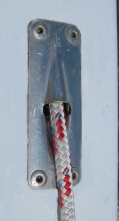

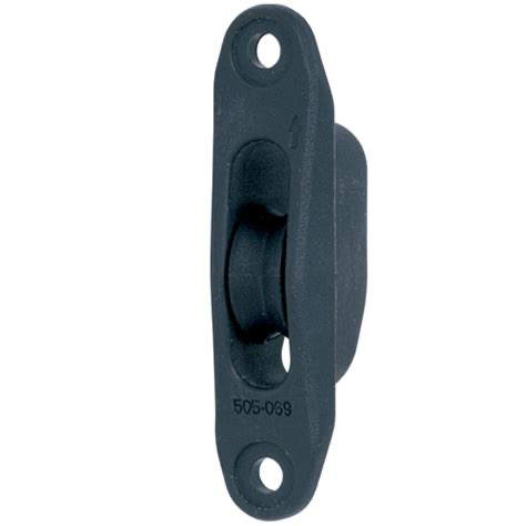

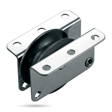

If you have the mast down you can install a sheave on a box frame in the mast.
You would need to cut a hole in the mast. Insert and secure the unit to the mast. Then run the halyard down the mast to an exit point.
or if you want to direct it to the cockpit.
Provide a way to secure the line (ie. a cleat). The benefit would be the only one line would be on the outside of the mast and thus only one line would be banging if you did no secure it away form the mast.

You state that you have a spinnaker halyard in place. It follows that your boat also has a sheave box on the face of the mast for the pole lift. If you do not have this rigging in place, just feed a new line thru and down , and fish it out of the unused halyard exit plate.... tedious work but we have all done it. :(
