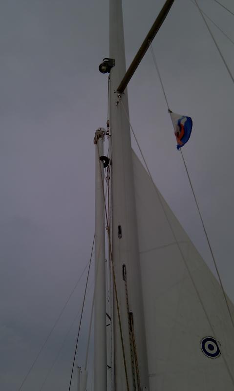

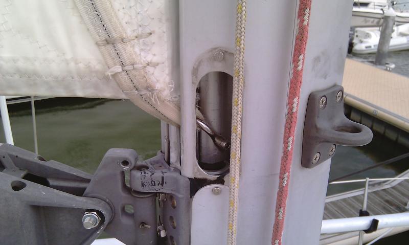

The boat came with the whisker pole and the pad eyes placed one on each side. Drilled and tapped holes in mast. See Photo

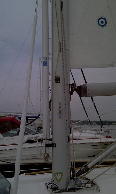

After one time tripping, I almost lost the pole so I put it on a permanent track to prevent losing it the next time. See photo
