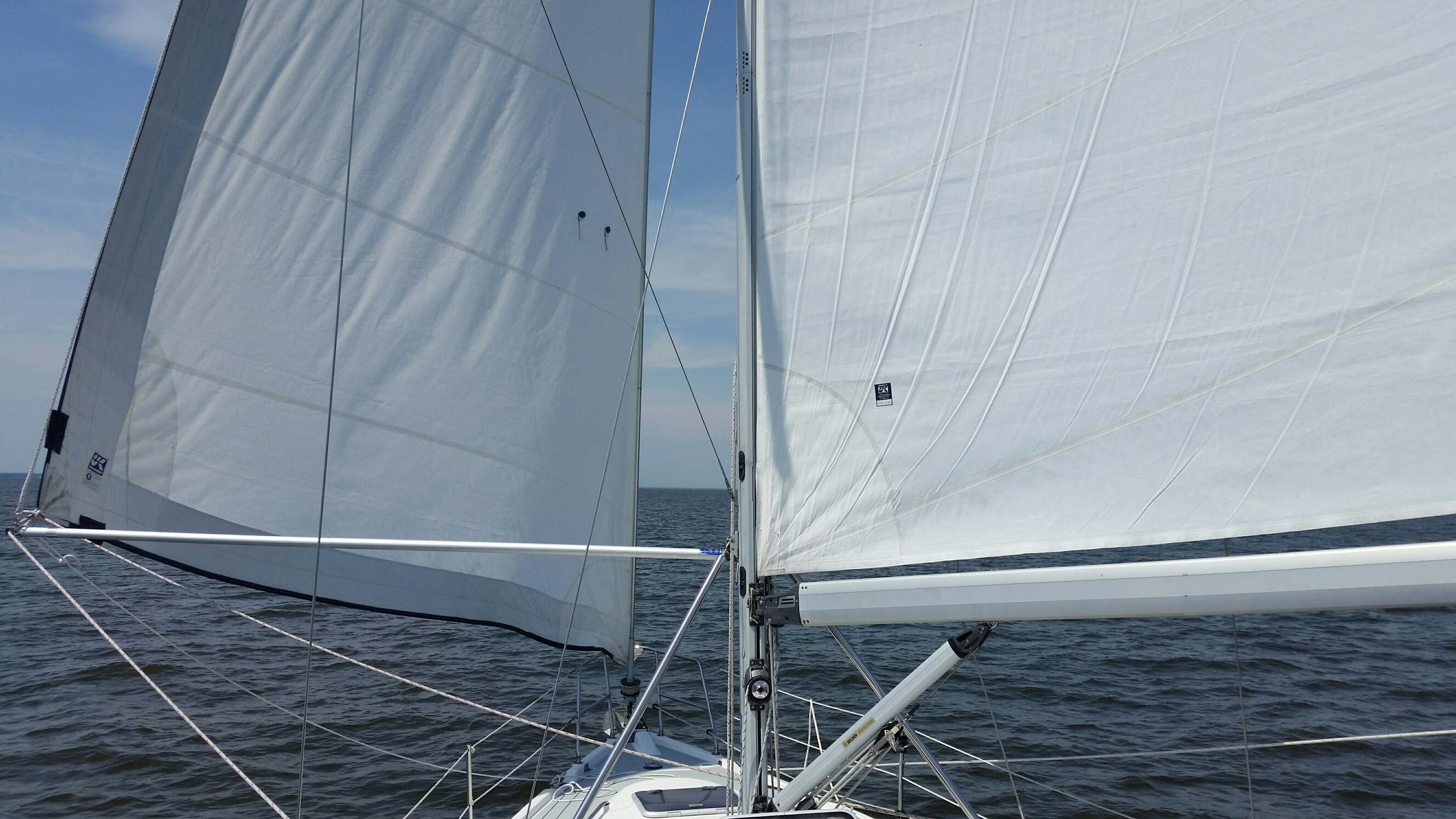

Have a 356 with a whisker pole and had never tried it and also got the itch to fly it. Not sure if you have a spinnaker halyard and 4th clutch on the port side, I didn't but easily added. Have the pole stored on the stanchions as a cheap solution.
Have a mast pad eye ring to support the pole and have a twist lock pole, which isn't that long with the normal 110 jib.
Get the pole and try it out, it's a blast and you'll feel like your really sailing. :biggrin:

Update. Finally settled in on a whisker pole fro Forespar. It's a twist lock. Our 356 only has a 110 jib and we don't fly a spinnaker. So it wil arrive with the bracket for mast mount pad eye. I'll let you all know what we think. Thanks for your help
