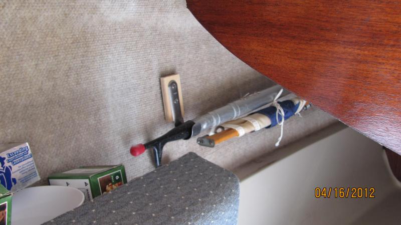

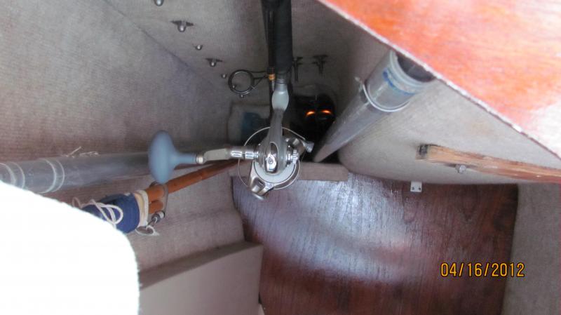

The problem with these poles and also the 12' telescopic boat poles on these boats is that they take up a lot of space in the cabin, but this can be solved by removing the aft Starboard bulkhead and cutting the portion that fits into the combing. I built a small wood cap and covered it with the same fabric that they use for the head liner. Then I mounted stainless steel pole hooks on a small square piece of 1/4" plywood with velcro on the back. This supports the poles well and the rug covered cap protects the poles and offers a nice soft shelf for them to rest on. If you go inside my cabin, you can't see the whisker pole unless you look toward aft into the quarter birth cubby hole on the Starboard side.
You can see the whisker pole in the next to the last pic just to the right of the boat hook and it's hidden behind the companionway bulkhead. It's pretty well hidden and very accessable to get at when needed. When I came up with this idea I named it "The mother of all mods."

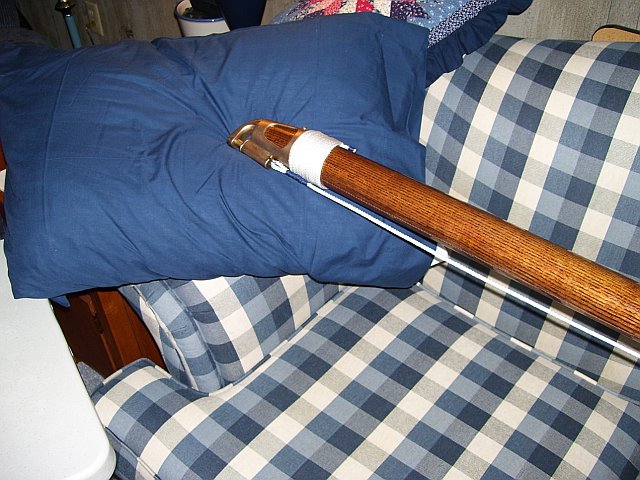

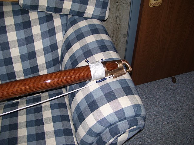

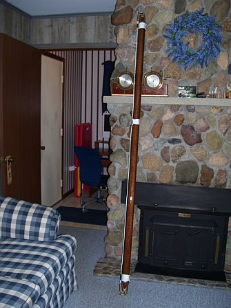

Years ago, one of the guys on the forum picked up two bronze end fittings at a yard sale or a flea market for only $15.00. He took them to an old German cabinet maker in Toledo OH and had the guy turn out a spinnaker pole out of Sassafras on his lathe. Then he finished it off and mounted the fittings. It came out like a beautiful piece of furniture. I told him that he had better not leave that out on the deck or it would grow some legs and walk away from him. :D
This guy's name was Chuck he and would often email me and we'd trade ideas on boat mods. We lost him a several years ago of Cancer and although I never met him I still think of him as a close friend and miss him like crazy.

I've never heard of using Sassafras for a spinnaker pole either George, until he wrote and sent me some pics of it. I've always dug up the roots and used them for tea. In fact there's some Sassafras that grows near my favorite cove on the river where I generally anchor out and do my beach combing.
Thanks George. Chuck was a friend to many on the O'Day forums. He had an O'Day 222 like mine named "Get Away" and he sailed parts of Lake Erie near the Sandusky area.

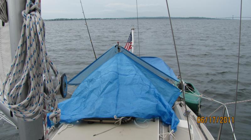

You're absolutely right. It is worth the money because I use mine quite a bit. One of neatest things I've done was use it on a run across the bay and all the way to the club on a rainy day with my polytarps over the boom and cockpit. We stayed dry all the way to the club. I wish I'd have bought a Whisker Pole years ago.
