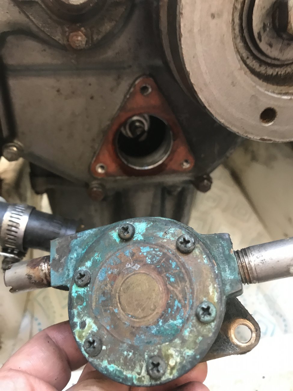

I have a 1978 Hunter 27 with the Yanmar engine and I need to replace the gaskets and the impeller on the cold water pump. How do I know if the engine is a YSE8 or B8 and does anyone have a part number for the water pump or seals. See pics attached

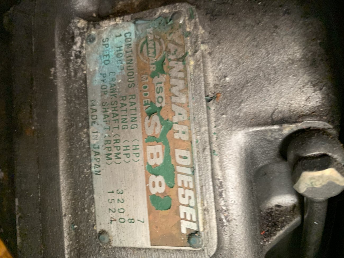

There should be a brass name plate on the top of the flywheel housing which identifies your engine..
Stick your head over the engine and take a look.
Sometimes they are corroded or missing.
Your photo is of a direct drive pump, both Yanmar YSE 8 and YSB 8 have belt driven water pumps.
You have something else.
The impellers and gaskets are pretty standard (see the attached address) and you can make you own gasket from copy paper or old chart paper.

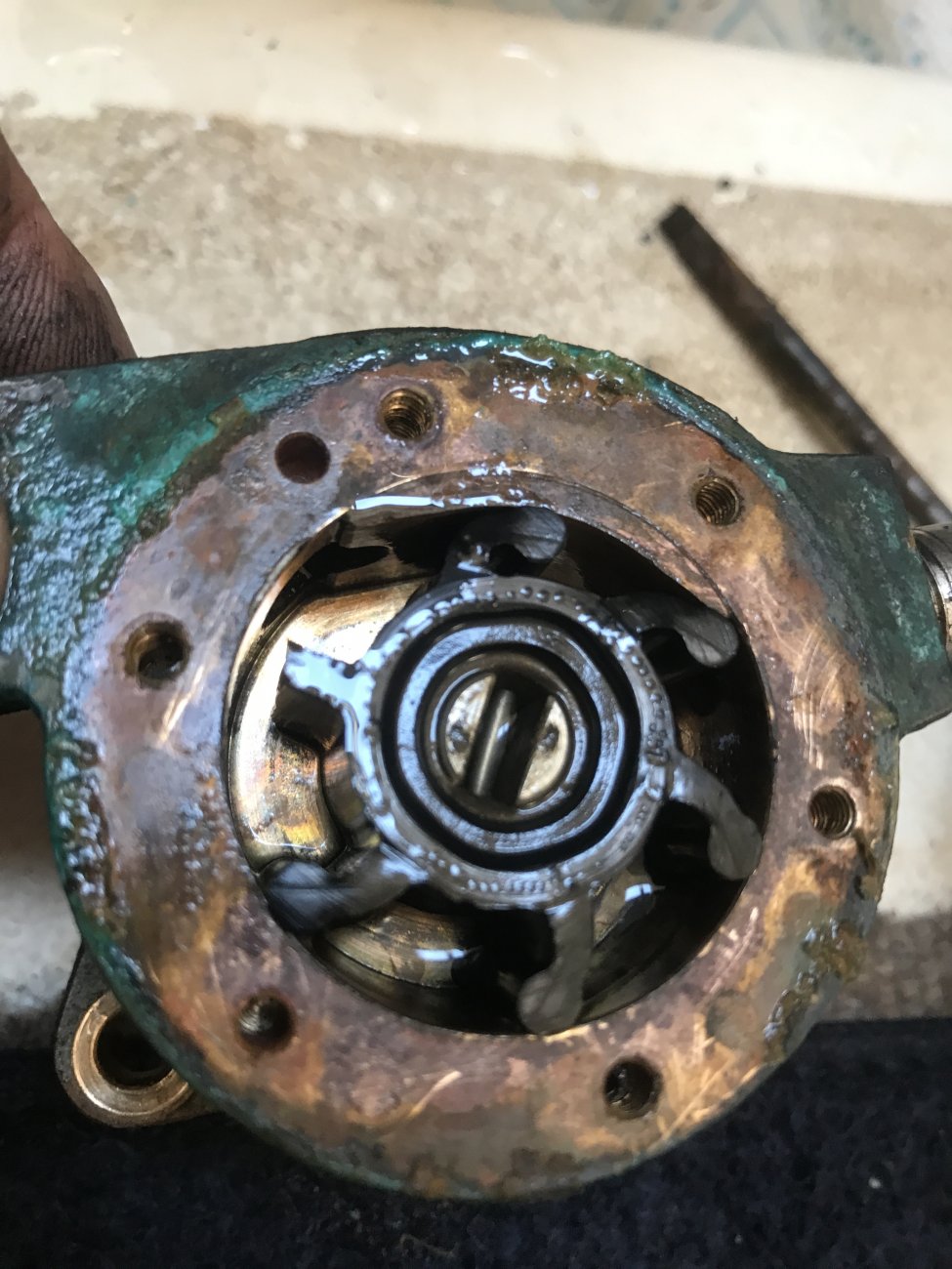

I take it from your reply that your pump is leaking between the face plate and the body (the bypass seal has allowes water in the boat twice this month).
The pumps can leak from there or from the shaft seal.
The face plate and body can have small scratches which make it difficult to seal even with a new gasket.
But they can easily(and cheaply) be fixed by lapping on a sheet of glass using valve grinding paste. Only lap as much as needed. The bronze is pretty soft and will grind away quickly.

First, I did find the plack to my engine the other day and it is indeed an SB8 (see attached) But, my pump is a bit different than the 1GM10 pumps I’ve seen in videos. Mine has a round impeller cover while others have a triangular shaped one. Perhaps mine is just a very early version but mine also has a second snap ring in between the water seal and oil seal. The 1GM10 rebuild kit I ordered from Poseidon only has one seal so I’m not sure if they got it wrong or I have an odd ball pump.

@garymalmgren Thanks for your help Gary. I know my post is probably quite confusing. As understand the pump and it’s function, if there’s too much back pressure down stream, the seal will move and allow water to be diverted out of a rectangular shaped hole at the base, which keeps the water from going into the engine case on direct drive pumps. Newer pumps with an external belt/ pulley may not need this. So, after a few minutes of running the engine, it will start to drip out of the bottom of this rectangular hole, then start to gush out, providing no water to the engine. I did remove all but the very last piece of my exhaust system and either replaced or cleaned out each piece to make sure I had sufficient flow and no back pressure on the exhaust/ water cooling lines. Since I wrote my last message, I had the pump apart again and found one of the seals not in place. Put it back together and again, after about 5 minutes I have water pouring in from the base of the pump (rectangular opening). The diesel smell is a different matter. It does not appear to be coming from the pump or the lines but the pan beneath the pump that holds the stuffing box drip and grime was full of diesel and water. Even though I had just cleaned it out a few days prior. The good news is, the engine runs well, I have plenary of power (for an 8hp 40 year old motor) but this pump issue is really driving me crazy and I have no idea where the diesel can in at. No apparent leaks on the fuel lines any where. The search continues.

I have never seen nor worked on that engine. It is an engine that was built and shipped in the 1970's. It is a flathead engine and some parts are still available thru your local dealer, Mack Boring located in Somerset, NJ whose number is 908-964-0700. Press 1 and ask for Michael or Jim. It would be helpful that you state the model is SB8 and serial number.. It is different than the 1GM/1GM10.

I am not familiar with the SB. it seems to have been a fore runner of the GM series.
From your description (is that information from a manual or did someone tell you that?)
if there’s too much back pressure down stream, the seal will move and allow water to be diverted out of a rectangular shaped hole at the base, it looks like there is a restriction down stream.
In your photo of the old impeller, half a blade is missing, has this by any chance lodged in the discharge hose from the water pump and caused e restriction? Or have you fished it out?
I would disconnect the discharge hose from the pump place bucket to catch the water and run the engine for a few minutes.Then you will know if the pump is delivering.
Next connect the hose to the pump but disconnect it from where it enters the engine. Run engine and check the hose is not blocked.
Next remove the water exit hose from the engine (it runs to the exhaust pipe water inlet port), Run engine and check flow.
If there is a reduction in flow at any point along the way. check it out.
You will get away with running the engine with no cooling for a few minutes at a time.
