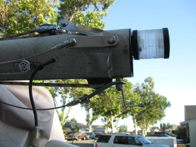

The larger one seems oversize for a 22, ymmv, my eyes aren't that bad yet. :D I looked at the antenna mounted one when my base bracket broke, (my fault, whacked it with a rake handle) but since the windex and antenna have to come off for trailering, the smaller one was a better option because the arms would have to be repositioned every time, and there would be more chance of bending or breaking something. This is a bad pic of my bracket, it is attached to the other side of the mast and sticks out far enough to be in clear air. The antenna mount is on this side and I put a 90deg bend in the windex arm.

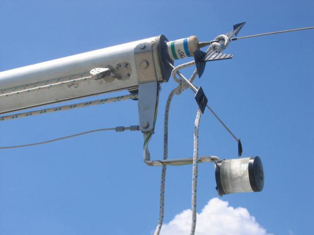

Here's the rigging that the PO put on Soire'e. We leave it on for trailering, but tie a piece of line around the indicator to keep it from windmilling. It's the same one Mike B1026 lists in his post. Not cheap, but worth it.

Actually, the arms stay in place when trailering. I just unscrew the small nut that holds the actual whip to the antenna base. The rest of the windex stays in place. It just takes a second to take the whip off.
