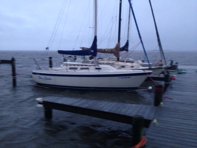

My slip is on the bay and along a channel so it has little protection from wakes and weather.

I've attached a photo showing Moon Shadow in it's slip and how exposed it is. On the outside of the last slip there is a plank bulkhead which breaks up some of the action but on this day the boat was rocking to badly to even think about going aboard.

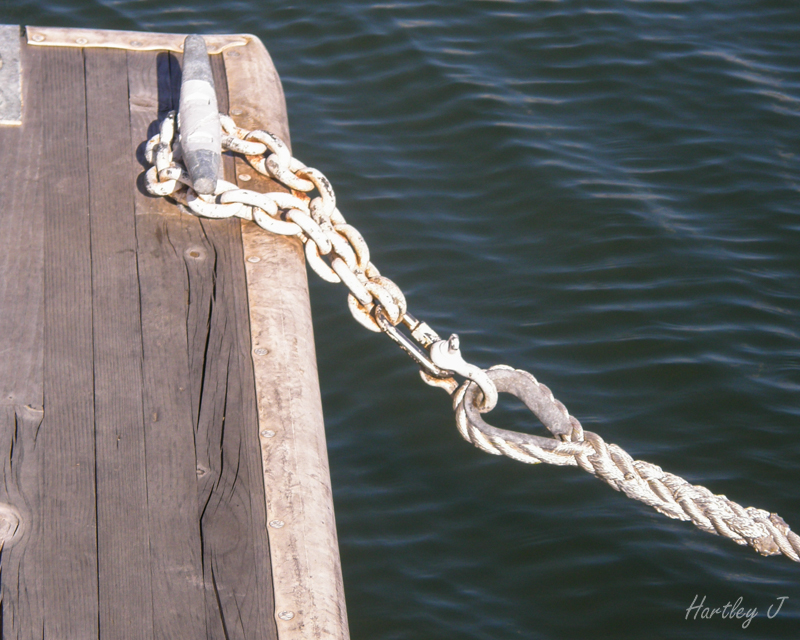

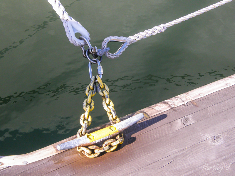

The very first boat we owned chewed about half-way through the docklines the first winter (in San Diego) - at the exact same place you encountered, right at the dock end where the nylon hits the galvanized cleat. I concluded that this was because the somewhat rough galvanizing was able to abrade the nylon - something that didn't happen on the smooth SS cleats and chocks on the boat. So I constructed some chain loops out of recycled anchor chain (3/8" BBB) and built up new docklines (see the attached picture). I've built mine with exact lengths, so no adjustment is required, but they could also be built with the boat end free, and therefore adjustable. I also put rubber snubbers on the short ones to increase the shock absorbing qualities. I keep a set of conventional docklines handy in the lazarette for traveling, but for the home slip the chain loop lines are quick and foolproof.
The original loops I built in 1995 are still on our current boat - they have been painted lots of times, and the lines replaced a couple times - but the loops appear to last forever. The second picture (with the yellow painted chain) is where I have both the bow and spring lines attached.

That's anice idea. I would carefull check the quick links though. I'd put the shackles right through the chain links, or use a carabiner. I have metal thimbles at the ends of my dock lines and put large shackles right through the loops of the dock cleats to that thimble. Same concept, different details.

I did attach to a cleat in Ensenada with a big shackle once, as one of the horns was busted off (yike!) - but that means you have to unscrew or unpin a shackle when you dock or un-dock. With my loops, all I have to do is drop the loop over the cleat and I'm done - and it works on almost any cleat. You will note that my loops are painted in colors, with a corresponding patch on the cleat -makes it easy to toss to someone on the dock helping you out - "just drop it over the yellow cleat".
As a (former) mountaineer, I like carabiners a lot - but not for docking - it's too easy, even with locking ones, to have them shake around to a position where they can be opened and/or overstressed.
I agree that the quick-links are the weak point, which is why I went to SS ones (plated ones kept rusting solid in a year, even when painted) - but they do get wrench tightened and checked annually. You could use a shackle, but you would need two, as you can't get an appropriate-size (reasonably priced) shackle thru two links of chain. I used the SS ring on the one with two lines in order to ensure that the quick link didn't get pulled out of shape.
One other advantage of the chain loop is that if the end of the dockline goes in the water, it WON'T be able to get to the prop until you get a LOT of speed on..:)

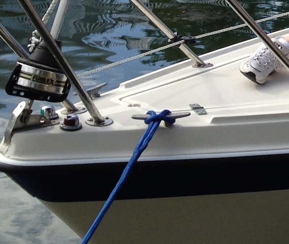

Found a photo I cropped to show how I loop my lines on my deck cleats. Shown is the 1/2" nylon double braid. Is this acceptable practice?

Not necessary to loop it through the cleat. Growing up as a powerboater, I always did that. When I switched to sail, the wrench at my marina made me a bet. He told me to just throw a loop around the cleat. He promised me if any one of my lines ever slipped the cleat, he'd buy me a brand new yacht of my choice.
Of the three types of nylon, double braid is the least good. 3-strand and 12-plait both have considerably (dramatically?) better stretch, reducing surge stresses. Double braid is best reserved for high performance (high-tech low-stretch) running rigging, not dock lines.

I agree with both weenie and SailingHarry - you don't need the loop/girth hitch around the cleat, and 3-strand twisted or 8/12 strand brait are much better choices for docklines. They're both easy to splice (get a hollow fid and a hot knife to make it extra easy) so you can make up exactly what you need.
Two reasons to not do this (besides it's like a "newbie sticker" or a former mobo guy :doh: like weinie said)
1. Most suggest leaving your dock lines at the dock so they are the right length all the time, hard to do this way
2. If you have to get out of Dodge quick, quick, quick, it's a PITA to remove them

SailingHarry, I agree. The photo was just to show how I looped the line. In my rather long beginning post I mentioned how I saw first hand how much more stretch 3-strand had than the nylon double braid of the same size. That convinced me to switch to 3-strand this year.
weinie, I've tried just looping them over the deck cleat but the angles appear to be wrong to ensure a slack loop doesn't pop off one of the horns. That close up photo is at a different location than my slip.
