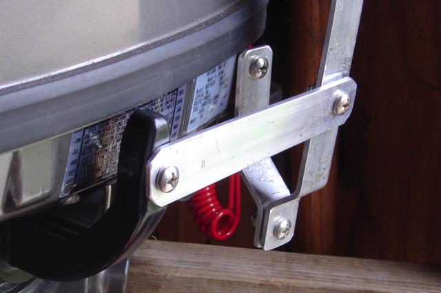

One other thought, you might want to check out Practical - Sailor on there report on the 6hp before you pay the difference over the 5hp for the 6hp. I can say nothing against the Nissan it has performed flawlessly. My only complaint came after I added the stern rail. (that of course was no fault of the motor) I found I could no longer get it out of reverse easily. The fix was easy, a gear shifter was added.
