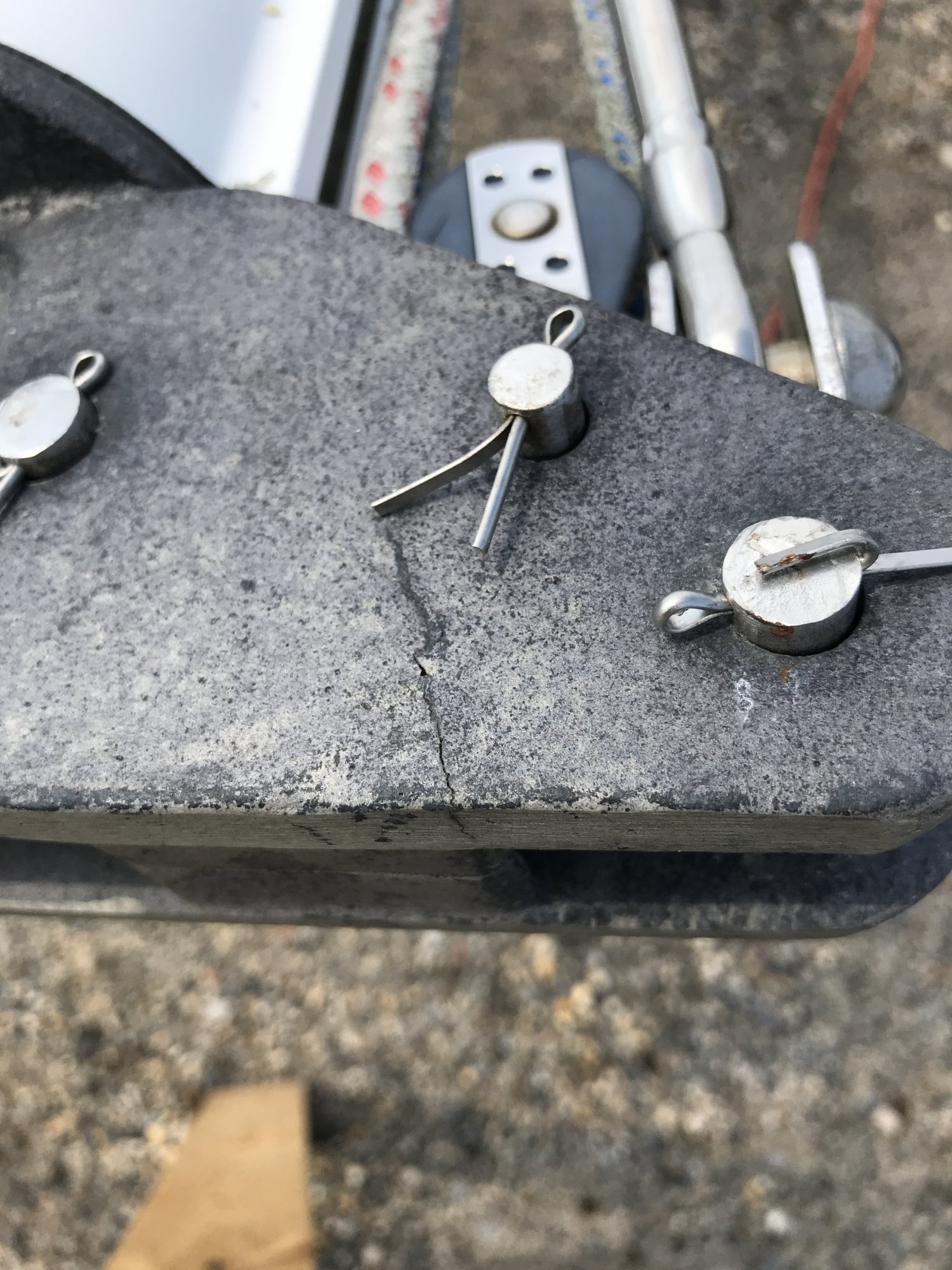

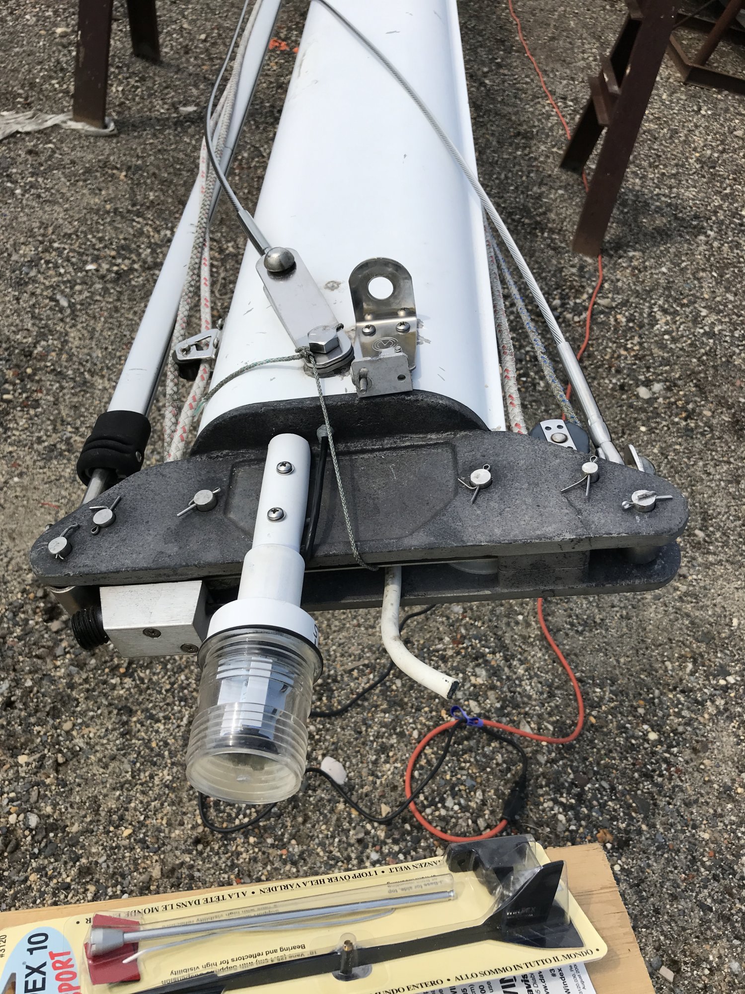

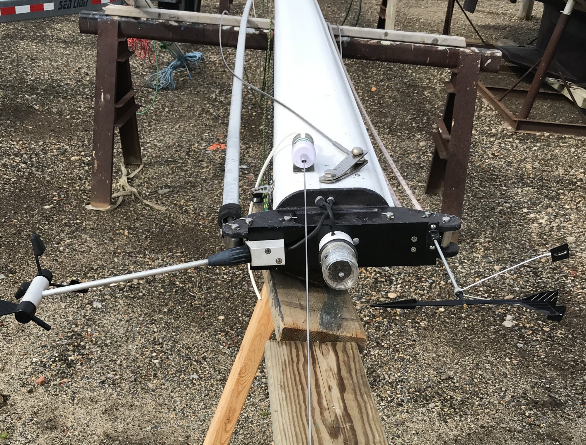

The pic is of my masthead after installing a new anchor light.You can see where the small block is attached.
The close up shows I crack I then noticed so I bought a new masthead casting.
That is when I replaced the sheaves and made some other modifications.

Wow! Ugly crack! I bet that was an unhappy day...

It was, until I called Catalina Yachts. They said they had two on a shelf that were covered with dust, to send a photo to confirm they were the correct ones. That was on a Thursday morning. They had one to me on Friday at a very reasonable cost.
Holy cow! That's awesome! A boat parts happy ending...
