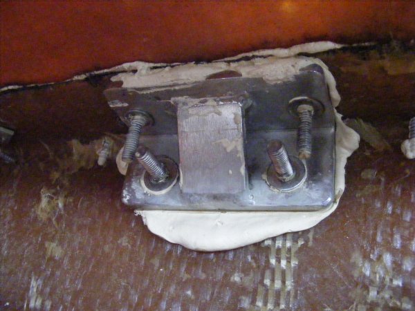

The chainplate design on my boat is a bit unusual but quite robust since the load is primarily taken by a large flange that is under the structural layup of the hull deck joint flange.  The bolts primarily just keep the chainplates in position.  The rig would probably stay up even with all bolts removed.
As I'm starting to prepare for re-installing them, I've discovered that they were bedded in an impressive thickness of compound, up to 3/8" in places. There is absolutely no sign of movement or breakdown of the compound after 30 years, 5 of which included my hard driving. I'm inclined to stick with what works and just re-bed using the old compound as a guide but there are areas where I will need to fill back to the original thickness and I will want a thin film of new stuff under the parts I'm leaving. I have no idea what was used in 1980 but it is still slightly resilient.
Anyway, what material would you use in this situation?
