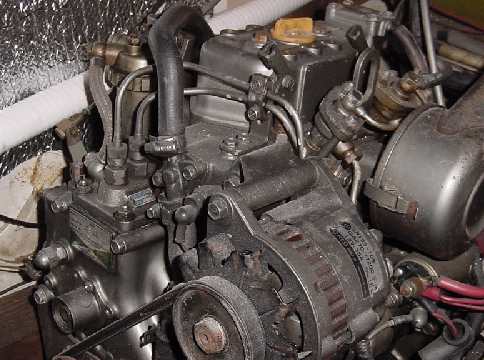

I believe that all 79 H33 boats were originally powered with 2qm engines. My 79 H33 has been repowered with a 2gm. The photo shows the engine and the identification plate location.
