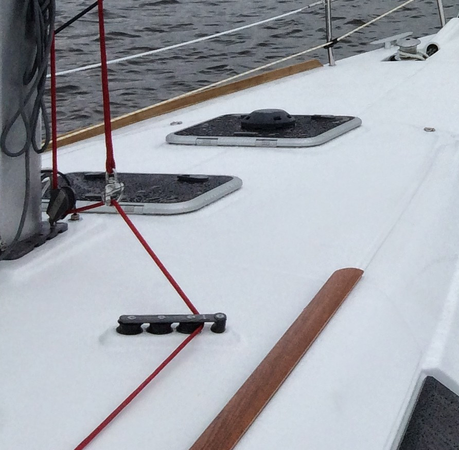

This is a picture of what Beneteau shows for the port side of the 361. Maybe you can tell the make from this.
May 17, 2004
5,696
The Beneteau 37 uses a Spinlock 3 sheave organizer for halyards. The Beneteau Spare Parts site lists it as a "D50", which I presume means its the 50mm model. The port side for halyards, mainsheet, outhaul, inhaul, and vang is the 6 sheave model.

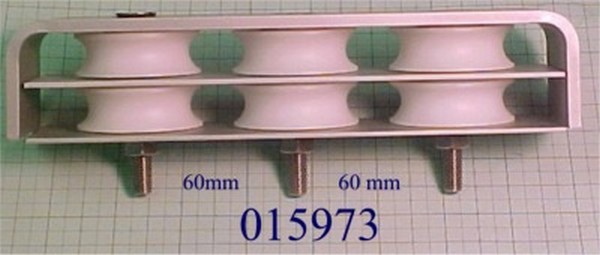

These are sparcraft deck organisers but last time I checked they are not available any more (not in Europe at least).
