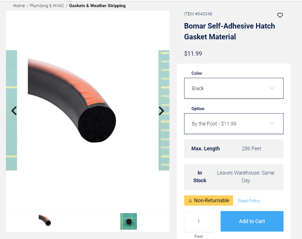

It "may" be something like this.
If you look on the acrylic lens, you'll find the model number very, very, very lightly imprinted. Use that to search for the gasket. If not, search Bomar's site and their manuals will help you identify your hatch.

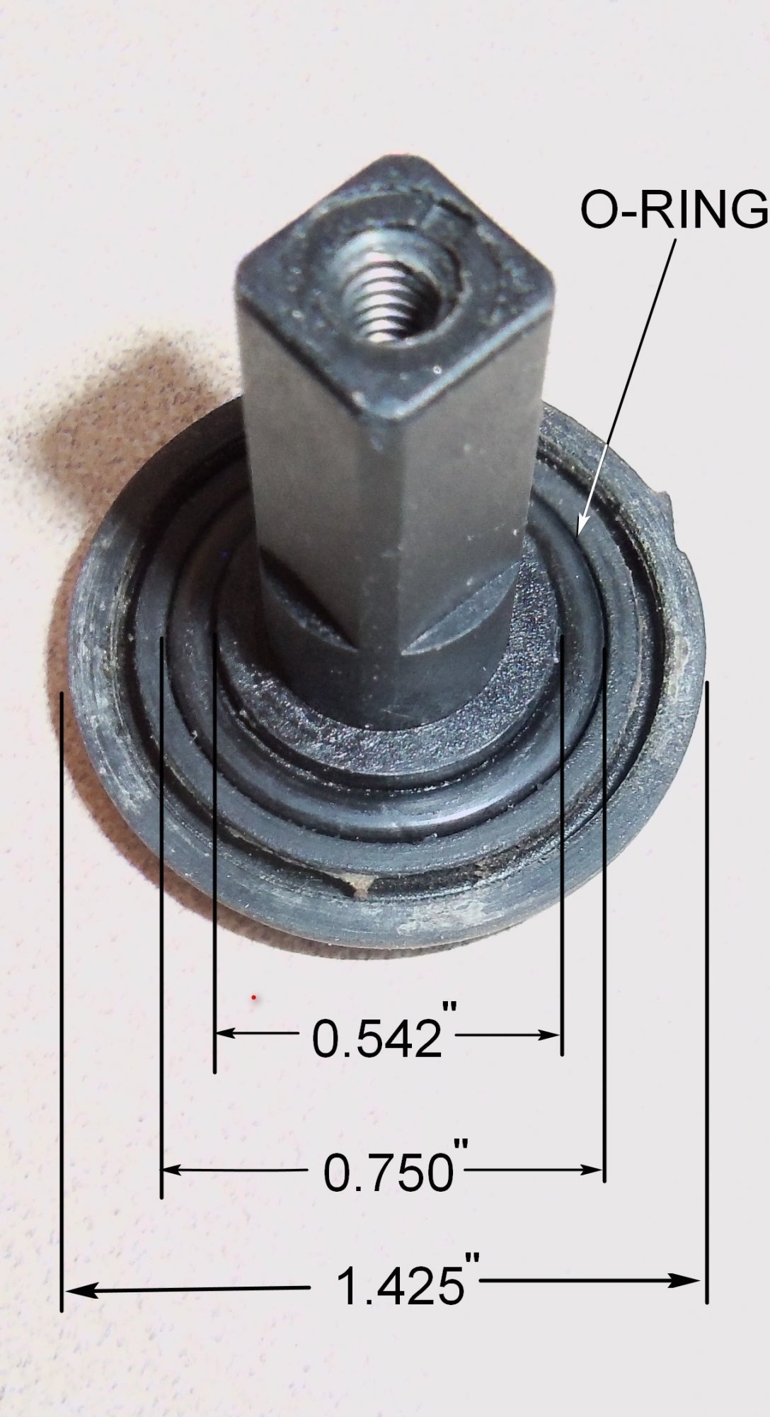

As far as the leaking dogs go, I'd guess that the drunk you acquired from the gin mill and then paid to do the repairs, forgot to replace the "O" ring in each dog :
If you're smart, you'll do the job yourself after reading the Bowmar manual. This is TRULY one job which requires a Grade 4 Reform School education at best. Could have saved the the gin money as well. Bomar has a good selection of manuals.
When you put the dogs back together, lubricate the "O" ring with a NON petroleum based grease. Use a petroleum based grease and they'll leak in time.

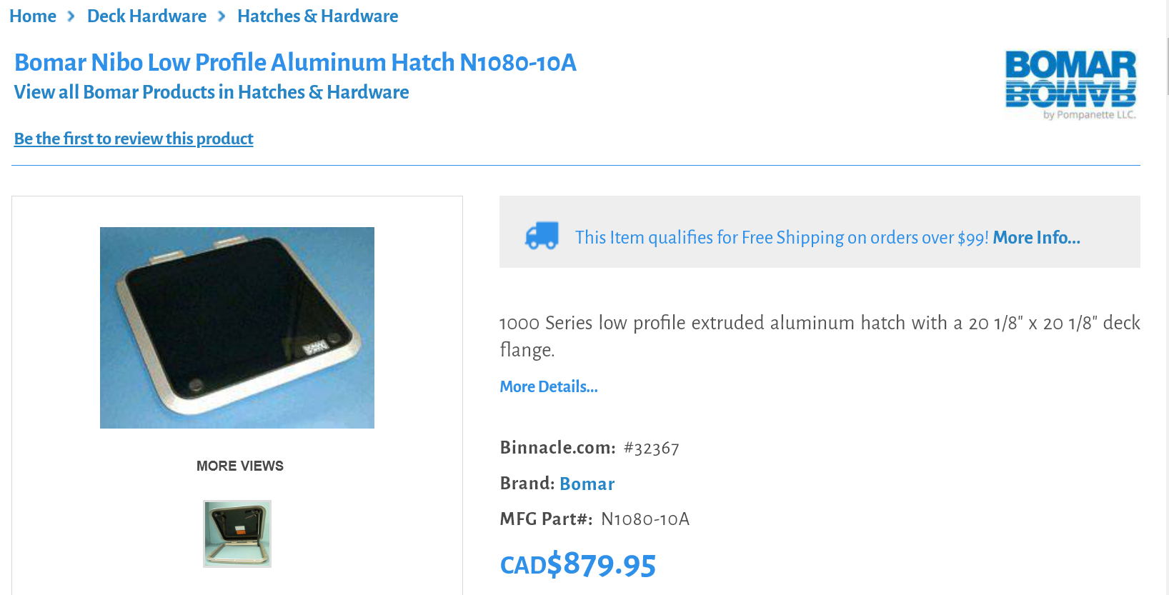

Do I understand you to say that you couldn't find the correct gasket for your Bomar hatch so you are going to buy two new complete hatch assemblies at $685.99 each ?
Whereas gasket material (yet to be identified) goes for $11.99/ft ? And there's still all the effort of removing the old hatch and installing a new one ? Hmmmmm .

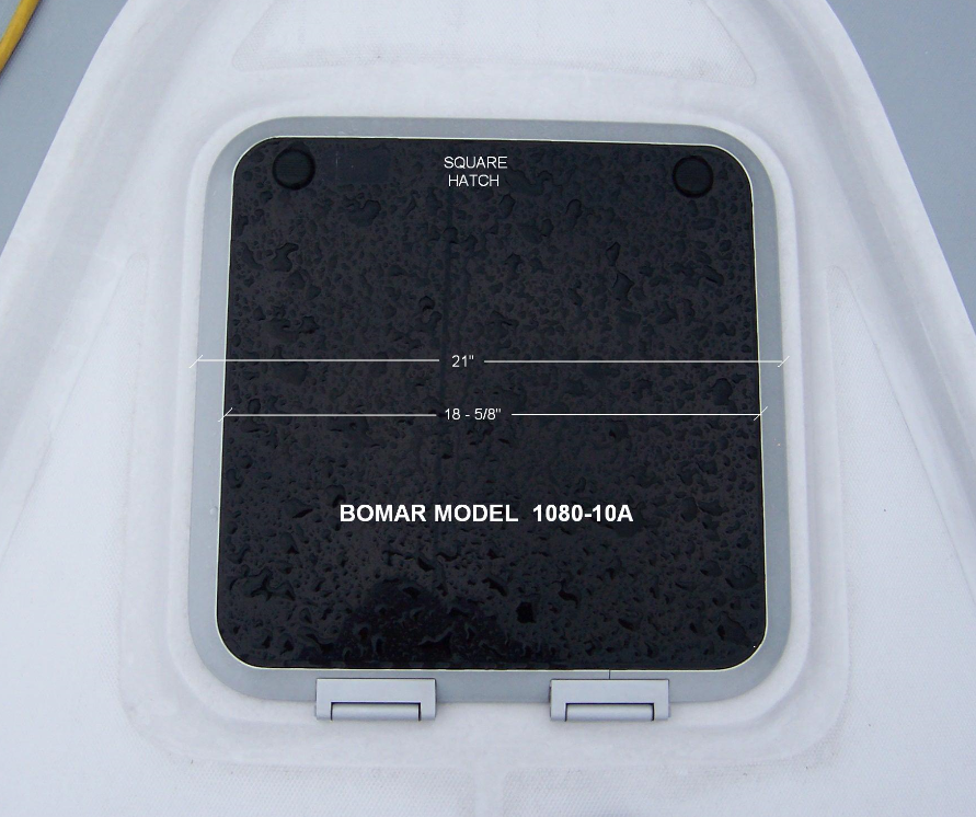

@spadaforaj , I see my old Bomar hatch model 1080-10A is still being sold today as a current model :
.......... and mine dates back to 1999. Yours dating back to 2004 surely still has replacement parts if you check the web for them. I would suggest you pry (but not cut out) a short section of the gasket material and photo the end view plus measure it out for shape, height, and width and whatever so you can supply a drawing to the vendor of what you are after. If you go with Defender Industries, I wouldn't be surprised if they sent someone out to measure it for you. Fantastic people for hard to get parts but they just about kill me with their shipping fees to Canada.
After you've measured the short piece, glue it back in with contact cement and it's there for life.

Hi Ralph, I tried 2 different gaskets with specs from Bomar. The gasket you are showing is for port lights. None worked.

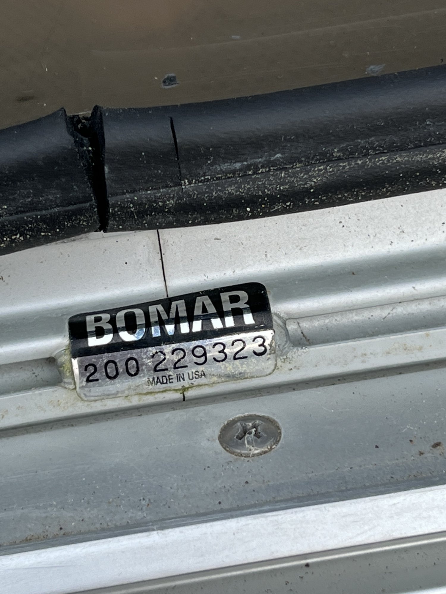

only thing I could read - I could make out the Bomar logo on the lens, barely You can see the likely leak source and i'm off to find some contact cement
