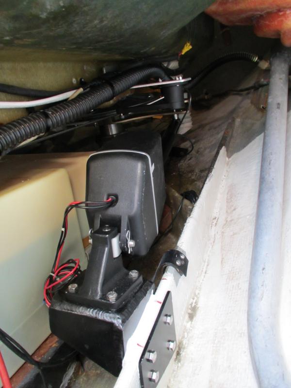

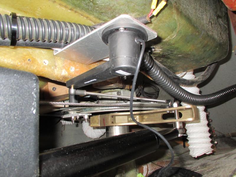

Raymarine Type 1 Linear Drive Installation in a Pearson 37
lorisjohnson, I had a type 1 linear drive installed over the winter. I've uploaded a couple of photos showing the installation.
