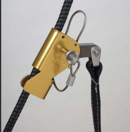

Looking to purchase one that will accomidate up to a 9/16 halyard
Suggestions

If I was going to use one the ATN would be a good choice. It is made of stainless steel Its open design allows it to be fitted over a taught halyard, synthetic shroud or stay from 3/8" up to 5/8" diameter. Ascender | Sailboat Gear| ATN Sailing Equipment (atninc.com). I know they are relatively popular (my berth neighbor climbs with 2 ascenders one on a separate rope) but I found the Swi-Tec Mastlift SWI TEC Mastlift 13m (swi-tec.us) with its is 10:1 purchase is effortless and fast to go up and down the mast and does not require someone on a winch.
