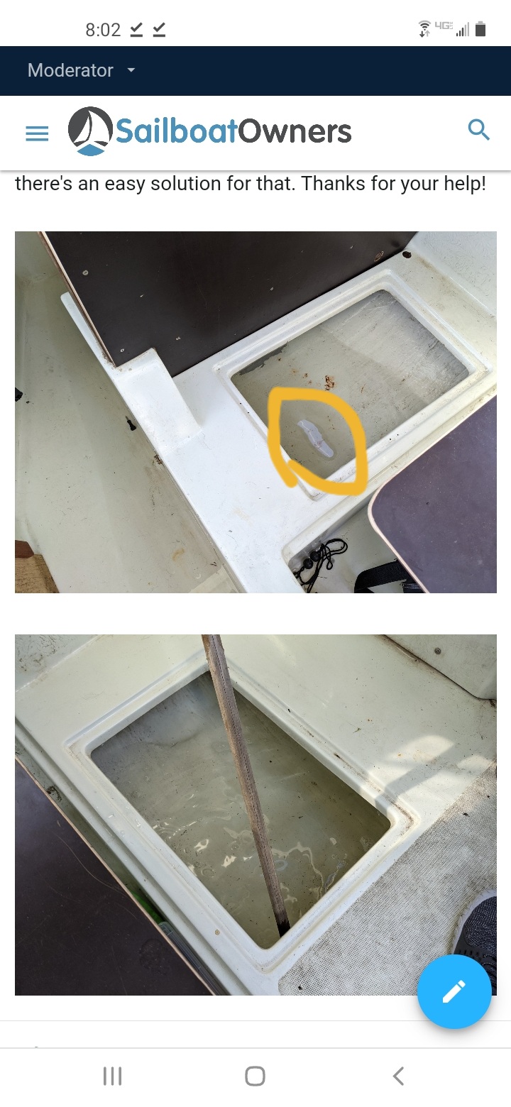

New owner, old boat! I purchased this vessel a year ago and have slowly been putting her back together. She's on a mooring now and I've realized she's steadily taking on water. Whether bobbing around in the bay for a few days, or after a day of sailing, I am generally finding a few inches of water in the cabin. It is mostly in the compartments under the starboard bench seats as well as the main floor area.
I have been slowly fixing leaks where I find them (cockpit drain thru-hull, anchor locker drain, winch strap hook, etc), but this has me stumped. It seems that the water is potentially coming in to the foremost starboard bench compartment and then flowing into the others.
I am speculating that it has something to do with the keel. Our water levels are quite low at the moment and, after leaving the boat tied up and keel down, I came back to find the keel bouncing off the bottom and 6 inches of water in the cabin after only one night. I have since started winding up the keel when leaving the boat, which reduces the water intake but does not eliminate it.
I have attached a few photos for reference. Has anyone had a similar issue and have some advice? I plan to do a dive on the hull when the water gets a little warmer to see if there is some real damage. I want to fix this properly but, for now, I'm also thinking of mounting a bilge pump somewhere but I'm a bit unclear as to where would be the best spot. I've noticed a breaker for it on the panel so I'm hoping there's an easy solution for that. Thanks for your help!

In my Sirius, under the forepeak there are closed compartments that are supposed to have foam for floatation - though that is likely completely disintegrated. On the port side there is a hole drilled between the compartment and the next locker (and further aft from locker to locker). This allows water to drain from these compartments to the lowest locker.
If I'm not mistaken, the starboard side chain of drainage is interrupted by the head area, but there is a hole drilled between the foremost starboard locker and the low bulkhead forward of it that separates it from the head and on which the dividing wall is built. This bulkhead is connected to the keel trunk as far as I know.
If I understand it correctly, - and if you can't see a leak - it is likely the leak is in the keel trunk in that area. This is because it seems your lockers are filling first, then, when the level is high enough to spill over the higher area much further aft, under the cockpit, the water enters the cabin floor.
As far as I understand, the keel holding bolt is above the waterline. I know this because I don't have it, just an empty hole, and no water comes in.
So, maybe the pivot bolt leaks - though you would likely see that as it's accessible, or there is more likely a leak in the keel trunk that is filling first the lockers and then the cabin floor.
I had my cockpit hose come off last year and half sink the boat as the cockpit locker is connected inside with the cabin, but you say the cockpit hoses are OK.
Maybe this is all a wild goose-chase on my part, but if it were me I would pull the boat out and deal with it. Otherwise you might end up pulling the boat out from much deeper.

I am the proud owner of a Sirius 21' since 2018. I also had this same problem of water infiltration in the starboard chests and on the central floor. I found two "natural" water entrances, especially when sailing in waves of more than one foot.
First problem: Pivot of the drift. / Solution = When the boat is on its trailer, lift a little (1/4'') the front of the fin with a hydraulic jack, just enough to be able to easily move the big bolt of the fin after removing the nut almost completely. Do not remove the bolt. Spread the two large washers, remove the old sealant, add new sealant (Sicaflex) in good quantities, tighten the bolts just enough so that the surplus comes out all around the two washers. Wait 24 hours and tighten again without squeezing too much.
Second problem: The two holes of about 2'' in diameter in front of the big bolt of the drift. / Solution = I stuck "Duct tape" on both sides.
Results: There is no more water entering my boat.

What is that?
A repair in the hull glass?
It kind of sounds like a crack in the hull. However, it could be the centerboard pin. CB trunks also can develop cracks from the CB working back and forth. They usually develop where the trunk is joined to the hull, just where the pivot pin is working on it. While that is a common spot for cracking. I doubt you would see the flooding mostly in a side locker.
