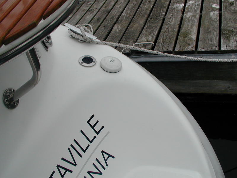

Where It Moves the Least
Ideally where it would move the least. That would be down low and also near the centerline of the boat. However, it also shouldn't be where the signal can be blocked. The signal can generally go through dry things but not necessarily through wet things, like a wet coach roof, wet dodger, wet sails, etc.
