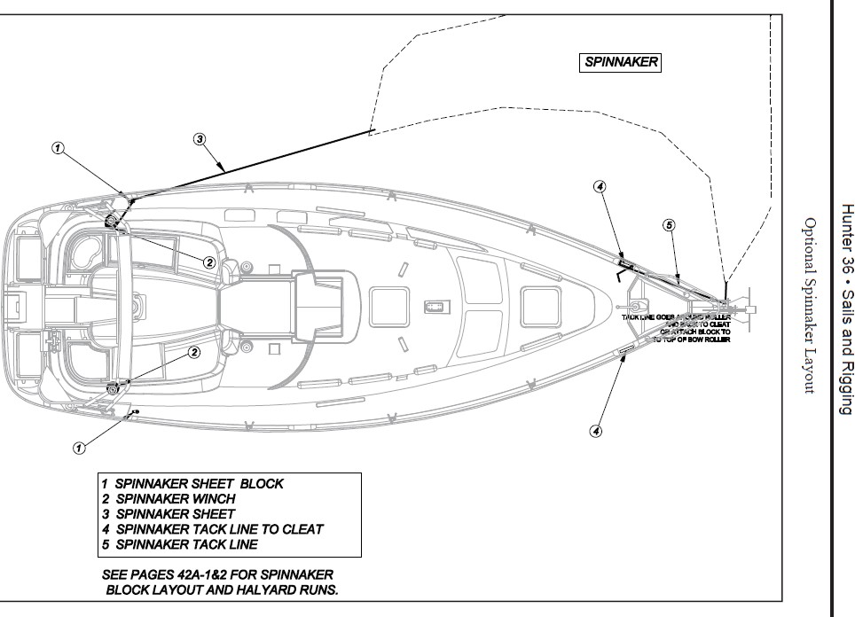

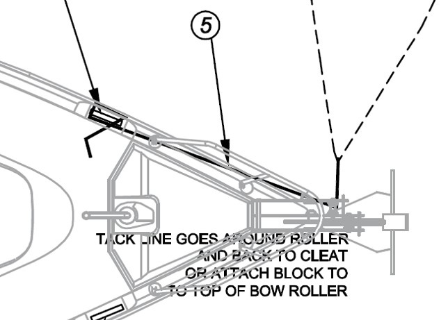

I was thinking a short pendant, maybe dyneema, to the anchor roller (I have one side which doesn't usually have an anchor on it). Probably with a snap shackle spliced to it and then a ring or eye with a thimble to a shackle on the tack of the sail.
As far as sheeting, would I run that sheet through the same cars as the jib sheets? that doesn't sound right to me picturing the boat in my mind. Or maybe a snatch block on the midships cleat? And then to the regular sheet winch? This is the bit I'm mostly struggling with.

I was thinking a short pendant, maybe dyneema, to the anchor roller (I have one side which doesn't usually have an anchor on it). Probably with a snap shackle spliced to it and then a ring or eye with a thimble to a shackle on the tack of the sail. I never used anyhing special, just a a short line from the tack attached to a hole in the anchor roller with a snap shackle. Others on the forum may have a better way to attach.
As far as sheeting, would I run that sheet through the same cars as the jib sheets? No, run the sheets outside of the liefelines to a block as far aft as possible then to existing jib sheet winches.

Since the spinnaker setup is temporary, only set when using the sail, this would be a good application for soft shackles. Some might suggest a line to the tack through the bow roller and back to the cockpit so that you can adjust tack height. In practice this is too fiddely for my sailing style. I'm not a racer. A soft shackle of sufficient length through the tack and around the bow roller is perfectly fine. Just need to watch for chafe on the stainless frame of the bow roller. Add chafe protection for peace of mind. For good sail shape, you also want the tack held as close to the forestay as possible. A set of parrel beads or device like the ATN "tacker" does the trick The Tacker | No Boom Spinnaker Handler | ATN Sailing Equipment I prefer the parrel beads myself. Google "spinnaker parrel beads"
As @sail sfbay says, run the sheets outside meaning the lazy sheet will run from the clew forward, around and outside the forestay then back down the opposite side (windward) to the aft turning block and back to the sheet winch. You will gybe to change tack and the spinnaker will fly forward of the forestay, then hauled in on the opposite tack. Look for youtube videos gybing spinnaker outside to get the gist.
You won't use the jib cars for spinn sheets. You want the sheet loading point as far aft as possible. A block on a soft shackle attached to the stern cleat would be a good setup that can be removed and stowed when spinn not in use. Similar to pic below except attached through the hole in the cleat.
Also note, you don't want to tie a stopper knot in the spinn sheet. If things go south you can release the sheet and let it run free to de-power the sail. This is also easier to douse the spinn with the sock. Oh yeah, don't forget to get a sock too!

*Install an adjustable tack line. It's easy to do and will make your downwind life much simpler, and safer.
*Install two sheets, the lighter the better.
*Install sheet blocks as far aft as possible. Then rig tweekers to act as leads for the sheets. Stability, control and shape are the benefit,'
