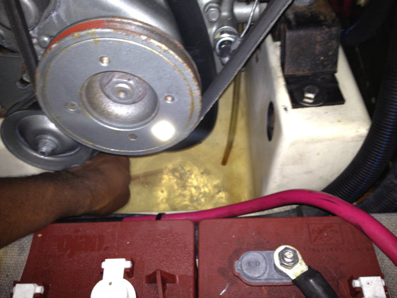

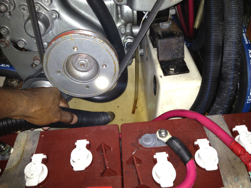

In our B361, after heavy rains, somehow, water collects right under the engine. It's getting inform somewhere and finding its way there. Just got down here today after three weeks and had about 3/4 inch. I shopvac it out but eventually, I need to figure this out. I've checked the most likely spots, or so I think.

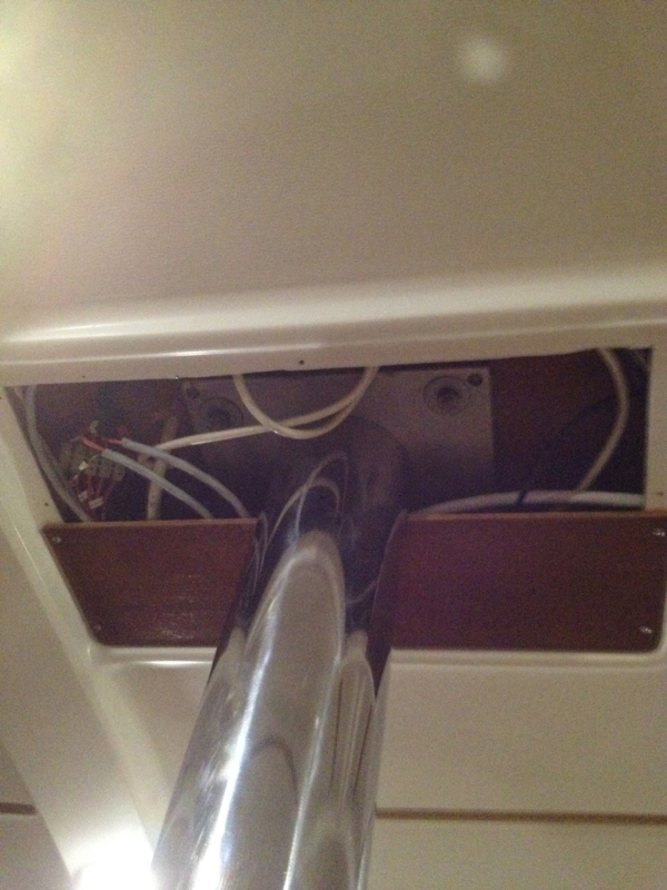

And speaking of leaks, it's raining sideways right now here in Oriental. Discovered a new leak, cabin top where wires come through the deck. That's an easy fix hopefully tomorrow if it dries out. It's a constant drip right now.
Nov 23, 2009
437
Beneteau Oceanis 361 Clipper --
Yes I have that too but it's easy to fix. Some silicone (a simple one nothing special) around the wires will do the job for a couple of years. Then you can replace again.

Bob, when I had Papillon I was getting water under the engine. I traced it back to the swim platform shower. Once I found that the handheld sprayer was leaking, another time it was the mixing valve. Both were very slow drips which took a while to find. Apparently the water would run down the hose and drip into the area just aft of the engine. Gravity moved it forward. In both cases it was because I had inadequately winterized the shower. If your tanks are empty then it would be tough to blame it on the shower. I'd try spraying the potential areas with a hose to see if you find any leaks. Hit one area at a time and give it time to find it's way to the bilge. Good luck.

I chased what I thought was a leak at the deck or through-hulls for several years. I even used an inspection camera. Finally tightened all the water system hose clamps and eliminated it. One method that helped was tearing papertowels in strips and placing along the hull where I suspected inleakage above.
I would pump or vacuum out the area around the engine battery on the 343, which has a very shallow bilge such that a little water goes a long ways. It also takes multiple tries over several days to get it out allowing it to flow through the hull bracing weepholes.
I got tired of fishiing out the portable pump or vacuum to do it and bought a section of 3/4 OD tubing that jams into the shower drain fitting allowing me to use the Whale Gulper shower pump to evacuate it.
Some small leakage is back, since after a few days withh the freshwater system switched off when I turn it on, it pumps back up to pressure for a few seconds. I'm suspecting the splice in the swim deck shower supply (burned through by heater exhaust). Good luck. Others have suggested spraying talc in various areas to see if water flows by.
