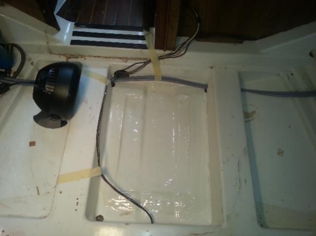

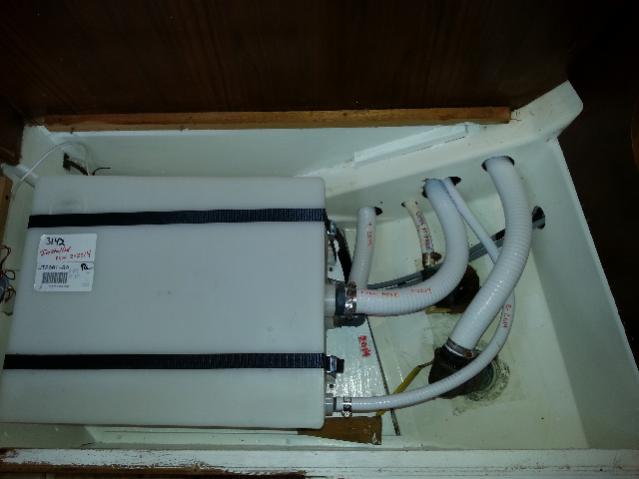

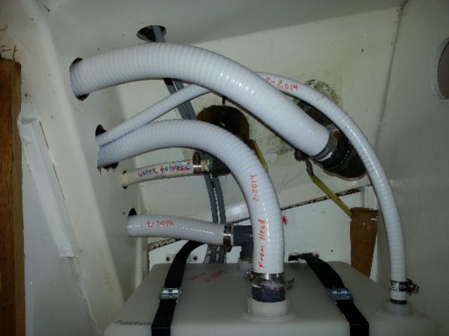

I recently replaced my holding tank also. No matter how I measured it. The only thing I could get in there was a 20 gallon. Because of the two thru hulls in that same compartment. My Y valve is on the other side of the bulkhead inside the head area. Hooking up the hoses and pushing them through the bulkhead really was not a big deal.
Feb 11, 2006
141
Hunter 34 Galveston,Texas
Sorry for so many pics. I just got a new phone. And I can't figure out how to post pictures yet. I can't even reply unless I quote somebody.
I don't have pics of the back of the bulkhead. But if you need to see where the Y valve is located I can take one for you.

Hi, Thank you for the photos! That is a clean installation for sure. Did you repaint the area bed you reinstalled the stuff? I have the floorboard honey/teak in there and when the water treatment machine was in there it leaked and what a foul smell it left behind. Im thinking I should remove the sole and clean under there! any ideas and also would you have photos maybe of the install of the y valve in the head? I really appreciate your input here, Tx, Christian
Feb 11, 2006
141

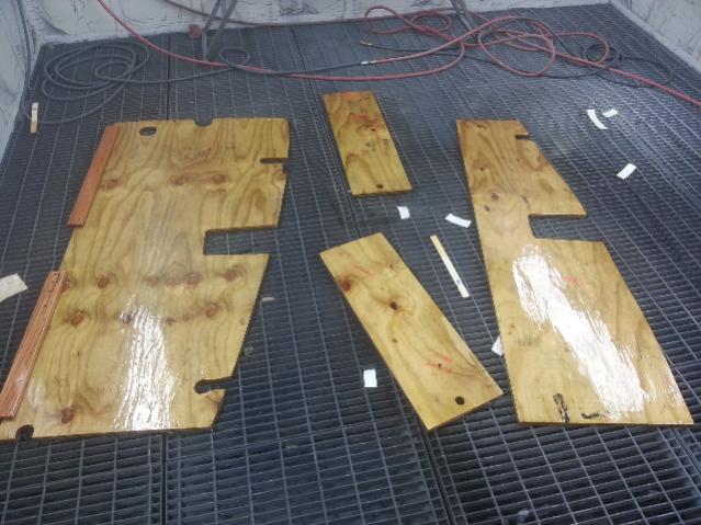

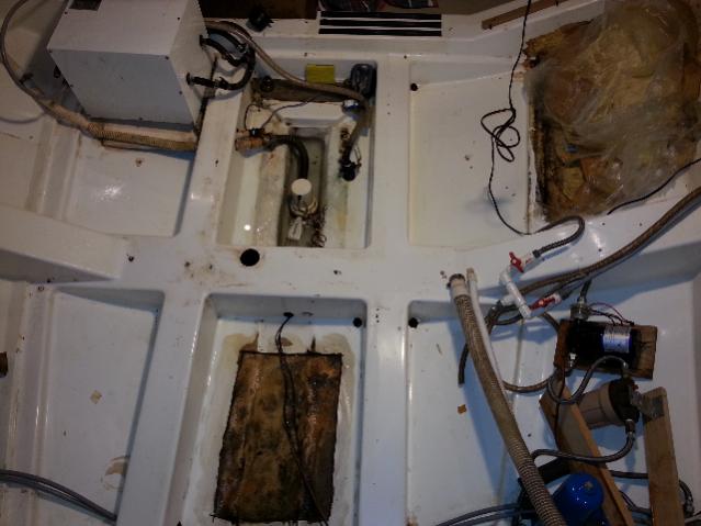

I replaced my floor this year.I coated the entire underside and edges of the wood.Then I put those snap together tiles from west marine under the water heater and holding tank.that way sweat and moisture are no longer a problem. I did paint the compartments before anything went in.I also discovered more real estate forward of the bilge.I glassed that in and now have more storage.
