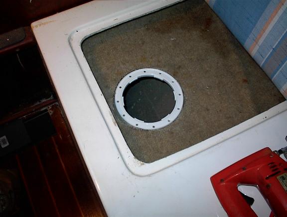

Peggy, you wouldn't suggest. . .
replacing the tank if you ever saw the installation on an H37C. There is one 50 gallon(advertised) aluminum tank glassed into the hull on each side. The hull liner is then installed. So you have "furniture": top, ends and front are gelcoated fiberglass with teak trim. These are the settees. In fact Ron will have to cut out the glass in a spot or two in order to add cleanout ports between the baffles. Gene has all the detail for this somewhere.

a few details
I'll try to describe it now, but pictures will help. Rainbow Chaser is about 220 miles away in Rockport, Texas now. I'm heading there Friday, then sailing for Galveston, then to Mexico. In about 3 weeks I can post some pictures. There are 3 sections in the port tank, (two baffles) and 2 sections in the stbd tank (one baffle). On the port tank you can get to the end sections through the lift out panels on top of the tank. On the stbd side, only the one in the front has access. That leaves two that aren't easily accessable. What I did was to cut a hole in the fiberglass/plywood above the centers of the two sections without access to the top of the tank, the hole being for an 8" pry-out type deck plate. Below that I cut a hole for a 6" deck plate in the tank itself. A person could easily go a size or two bigger. You could also use something else to cover the hole, like an aluminum plate or any one of many other options. Imigination can help here. I originally cut the the holes for the cleanouts in mine just to be able to clean out the tank. My first shot at this came after I'd cut out the stbd side of the interior to move out the settee, found the tank was loose and floating around in the side of the boat and took it out on the dock to wash it out. After using a hose and shaking it until I got over a gallon of crud out of it, I decided it (and the other one that was still in the boat) needed more access. Recently I wanted to convert the port tank to a fuel tank, and when I found I needed to seal it, I cut much larger holes and used an aluminum plate as the cover for the cleanouts. I just cut a hole about a foot square in the end compartments, then cut a plate of aluminum I got in the scrap yard to go about an inch farther all around. I drilled and tapped it all around, sealed it up and it works fine. I can say that the 6" cleanout is difficult to work through and it would have been easier if the hole was larger. I'll try to take some pictures and post them when I get back in about 3 to 4 weeks. Feel free to send me an email to remind me.

Okay... I get it...
Thanks to everyone for your input on the water tank problem. I'll weigh all the information and make my decision. I can see that there is no easy fix here. I've attached the only pic I have of the tank set-up. Hope it clarifies what I'm up against. I think my big mistake was in adding inspection ports and cleaning the tanks last year.. And Gene; good luck in the race. I had a chance to go, but opted for refridgeration classes instead. Maybe in two years.... Ron
