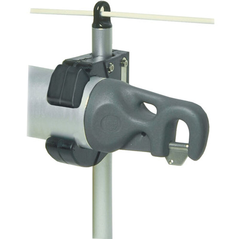

That’s what I use, although I mounted the chocks to the bottom of the stanchion instead of the top. Pole is nicely out of the way and still easy to get free.
I have a pole, but no spinnaker on my 35. In the summer I keep it mounted to the stanchions on the starboard side as David states above. In the winter, it supports my boat's winter cover.
