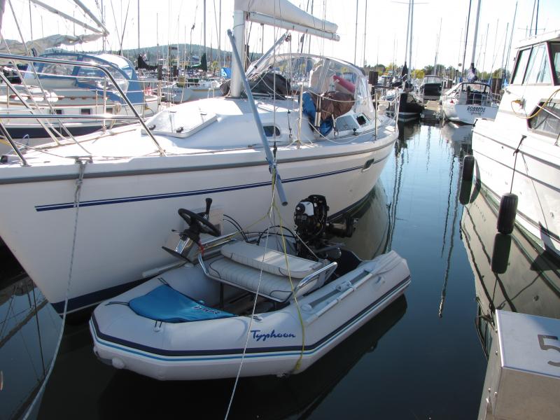

At the boat show a new, larger air deck dingy called out to my wife :eek: and I did not have the heart to say "no dear were fine with our little roll up and 2 HP motor", so the new boat entered our life, with 6 HP 4 stroke, and all the goodies. After blowing the boat up in the family room, and repackaging it first thing noted was, this will no longer fit in the locker for storage, and will need to be stored some place else, maybe inflated for ease of use, and out of the water to keep the scum off, and water out.

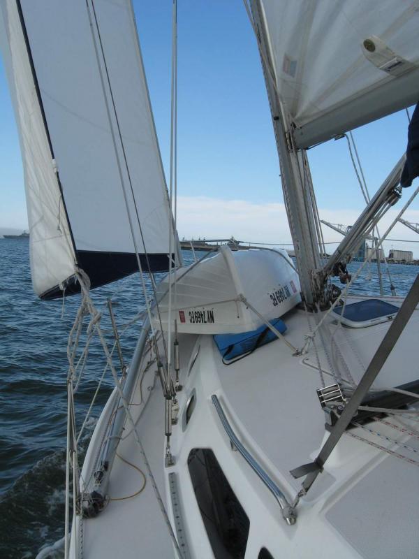

I carry a WM 310, fiberglass bottom RIB which is around 9' long with a 6hp outboard. When off shore the dinghy gets hauled on deck using the spinnaker halyard. I typically do this alone but it is definitely easier with a helper. The dinghy is lashed upside down forward of the mast with the bow of the dinghy facing forward. The outboard lies on its side in the cockpit locker for long offshore trips or gets hung on the rail for short trips. I have enough stuff in the locker to firmly wedge the outboard in. When I am making coastal hops or jumping in and out of the ICW during good weather I usually tow the dinghy behind with the motor attached. I am considering a set of Garhauer davits this year for coastal cruising.

Tow it for short or protected trips, but we put the walkerbay 8 up front on longer trips or in iffy weather.

In the Garage for the off season, on season, on my boat lift on my dock, hanging from the davits when we are on the move.

We store our Walker Bay 8 upside down on the foredeck for the off season or during heavy weather when we are cruising. Otherwise, we carry the dinghy on davits. The spare jib halyard works fine for lifting the dinghy onto the foredeck.

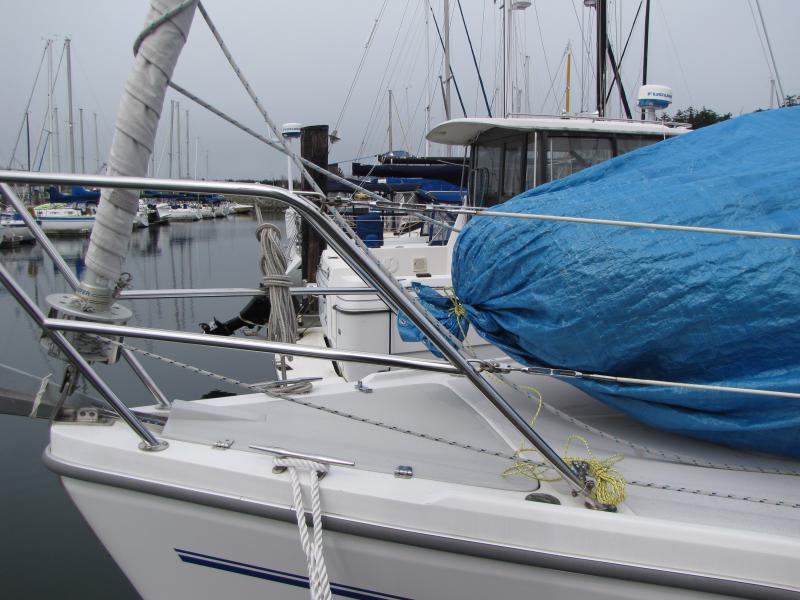

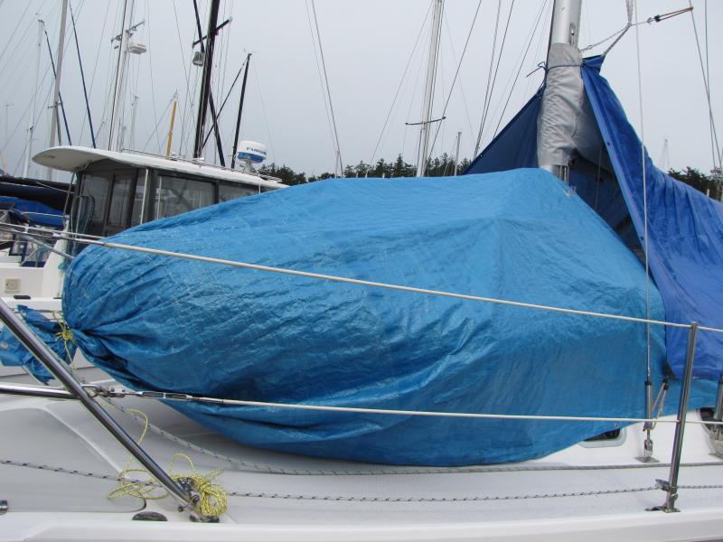

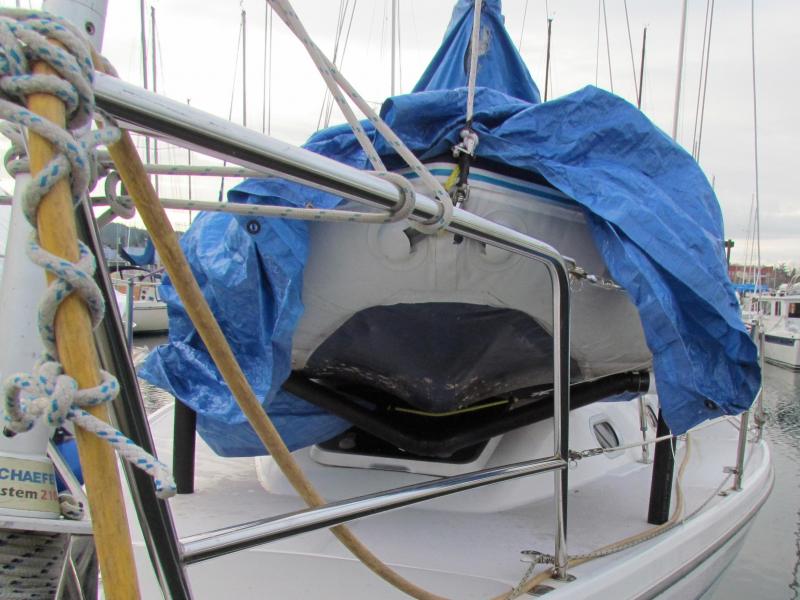

Even though the name is Russ, call me stupid if you want to? :confused: I am confuesd even with photos :doh:. You swing your dink up on deck and bag it? Are you tied down in any way to be secure to the deck? Are you on the coach house or between house and deck? For you people that responded you store on deck, flipped over, where do you tie off, and do you block under the transom? This should be so easy, but last year during a storm there were two flying dingy's in our marine :eek: that left the deck of their respective boats, did some interesting flips and flops.

When we store our dinghy on deck, it is upside down forward of the mast. The transom of the dinghy rests on cushions at the mast base, and the bow of the dinghy rests on the anchor locker. We secure the stern of the dinghy with lines to the forward shroud mounts. The bow is secured with lines to the bow cleats. In addition, we pass a heavy line over the dinghy about amidships and secure it to stanchion bases. This arrangement has worked well in high winds and heavy seas.
