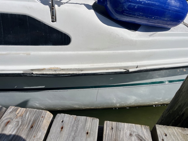

Last night a storm did some damage to the Hunter 23.5. It was tied to a dock with 4 large inflatable bumpers. The stern cleat broke off due to 22 MHP winds. The boat moved and hit the dock for hours without the inflatable bumpers. The 1 1/2 inch bumper strip on the boat got damaged, plus a small crack on the fiberglass. Where can I buy a 3 ft section of this bumper strip? See pic.
Thanks in advance for any comments.

Ask for Mike at this forum store extension 106 as he originally ordered the rub rail for the 23.5.
Can you share some photos of the damage?
Have you considered adding fender material to the dock and posts ?
That cleat is secured with two machine screws into aluminum plates encapsulated in the fiberglass. Suggest larger cleats with thru bolted ss mashine bolts into a large stainless steel plates inside the boat. There is no wood in the deck

Hi Crazy Dave, Yes, I plan to add fender material to the pilings on the dock, in case this happens again. I secured the cleat today with #14 SS screws I bought at Lowe's. So far, so good. Thanks all for the adivce.
