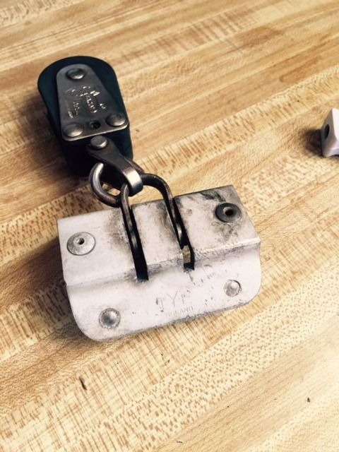

i acquired a Tahiti Ketch (see photo) here:
The missen sail unfurls and is pulled aft by a combination of furling line and a car / traveller? (not sure of the correct term) which runs on a "traveller" attched to the top of the boom

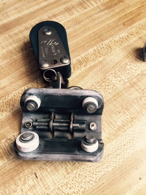

The wheels on the "car' have become badly worn and it jams, stopping the sail in the early stages of unfurling.
The "car" (see photo) has a stamp on it YTE England - i have failed to find YTE despite numerous Googles
Second photo here:

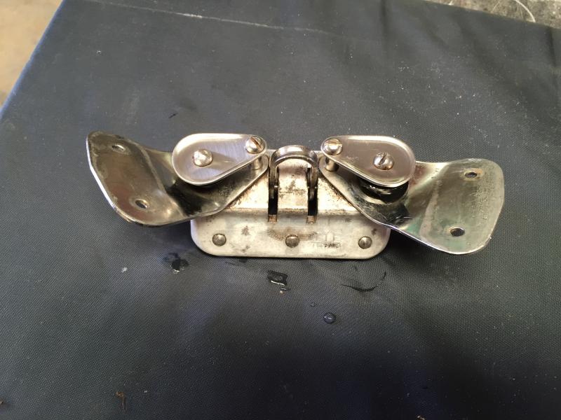

i think i have one of these in my stash i will look and see if the wheels are any good and let you know ....by the way that's a good looking rig you have there.....if i do have it you may have it for the postage.....

Bill mine has 3 rollers on each side and it is usable i will take some pics and post it here ...it6 is made by the same company yours is ...this came off a Irwin sailboat and i think it was used for the travel car for the mainsheet on the boom ...it measures 3 and 5/8 inches from end to end where yours may measure 2 and 7/16 end to end so it would be about 9/16 longer from the center of the u shackle to the end but i think it will still work for you ...also the wheels will come off by removing a e clip keeper on each axle so no mater what it will be a good parts source for you

Looks like it has "C" clips holding the bad "wheels" on. Perhaps a friend with a lathe could turn you some out of nylon as a last resort.

dia of the shaft looks to be 7/32 or 5.5 mm on mine
and
wheel is 11.5 / 12 mm in dia

shaft is .250 thousand/6.5 mm
wheel is .700 thousand/17.5 mm
you can have them made from uhmw by a machinist over there they have been know to drill a hole down the center of a needle

A traveler is a mainsail trimming device used to adjust the sail's "angle of attack". A traveler's primary parts are a metal "track" and a "car".(or a travel car, most people just call it a car) The car travels on the track. There are sliding cars and there are roller bearing cars.. There are a number of devices on a sailboat that use a track and a car... the jib fairlead system for example. Or your mizzen's furling system.
If you know the name of the furling system you might be able to track it down that way.
But you're more likely to get a hit if you pass the picture around to some yacht surplus stores... You can simply email them a picture of the car and your track and some basic dimensions. The main thing is to identify your track type and size Because they might be able to match it up to another manufacturer's car.
Here's a a traveler car for a Prindle 16 beach cat... You can purchase it new from Murray's online for $80. But you still need to know if it fits.. include the dimensions and shape of the track in your search. Good Luck.
