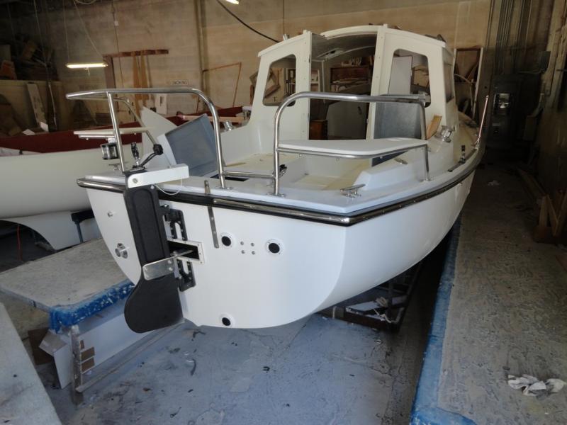

I'm toying with an idea similar to the picture. A transom wheel with a no feed back Teleflex helm. I would use a stainless steel wheel instead of the traditional wooden one shown.
The picture is from a Com Pac Horizon Cat. I talked to Gerry Hutchins over at Com Pac Yachts about parts to make this system work. But if anyone on here has any ideas I would love to hear them.
I feel a pedestal wheel would take up way to much space, by the time it's lower than the main sheet the pedestal would be at the jib winches. Any ideas? Comments? Suggestions?

If you need to build it out from the transom like the Compac then it seems it would take up a lot of space. If you go through with it convert it in a way that you can go back to a tiller without looking like a hack job in case you don't like it or want to sell the boat. Maybe there is a way to build something temporarily without cutting holes in your boat to see if you like it. Just curious why you want to convert?
Jul 4, 2014
20
Catalina C22 Woodstock
Absolutely would build it in a way that I could easily return to a tiller. If you look close at the Com Pac pictures its almost just a mahogany box built between the seats. I figure if the whole thing comes off the transom into the cockpit 16" than it would be less than the length of the tiller sticking into the cockpit.
