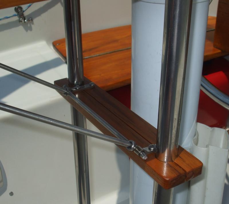

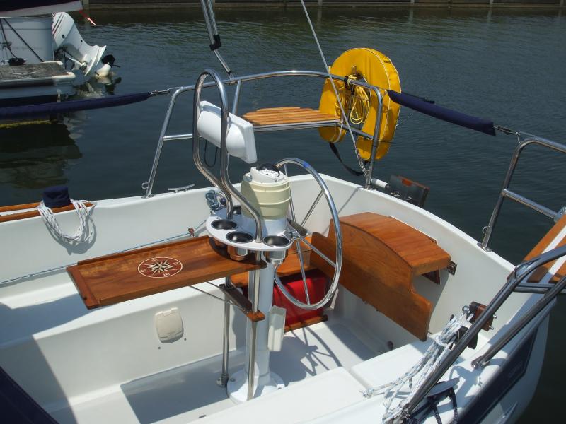

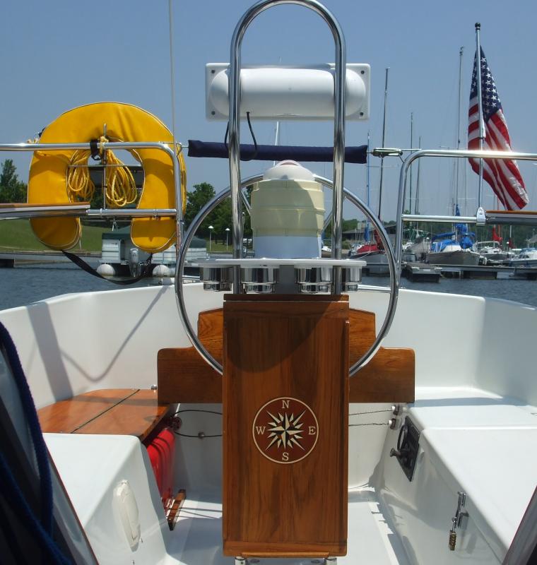

Here a picture of a Teak table I made for our Seaward S23. You are correct the prices of other quality teak tables and their hardware kits are out of this world. Note this is custom design and mounting system, but can fit any pedestal guard. Also note the Compass Rose, these are found on high end tables. Let me know if you are interested.

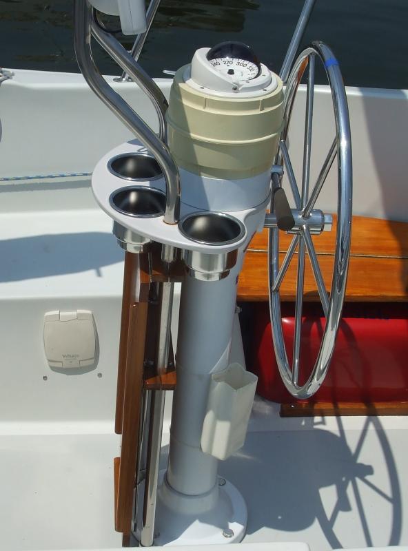

Spindrift NH: Thanks for your nice comments. I have "Champagne Tastes," but unfortunately I am on a "Beer Budget." I wanted a custom solid teak table that would complement the pedestal, while adding a high level of function to the cockpit. The design I developed does that.
The first picture shows the table folded down against the pedestal. The second picture shows the unique method I came up to attached the assembly to the pedestal that includes a SS piano hinge. The last picture shows the bottom support piece. Note the 1/4 SS rod that is bent to form the table's support. This provides an extremely solid table when it is in the up position.
If you are interested in adding these features to your existing table, I think I can help. Call me 513 891 5112 Pat.
