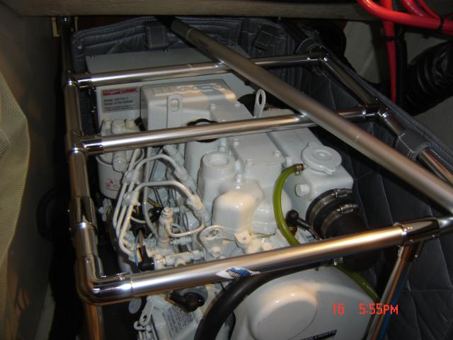

We had a Panda or should I say 2 on our 376. When I replaced it I installed a Entec west It was great and they are a really good co.
http://www.entecwest.com/ It was in our aft cabin we took out the seat. That was a great boat sails well
