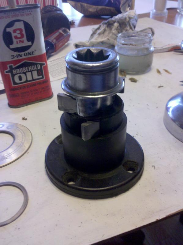

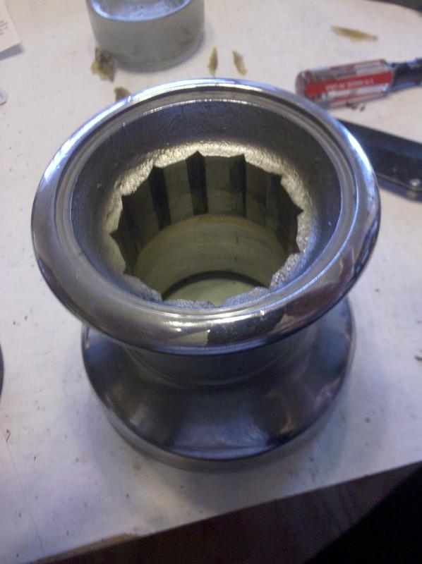

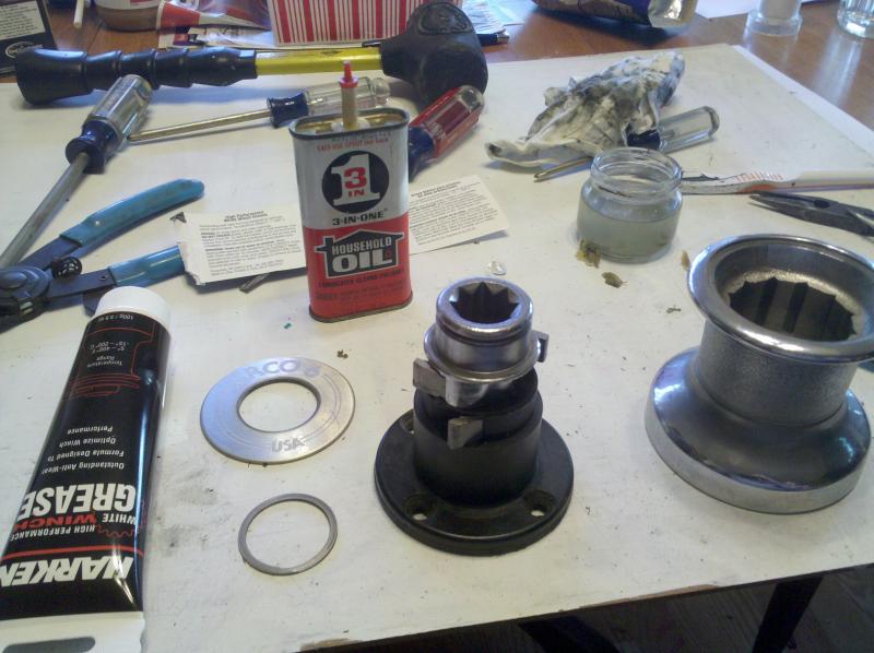

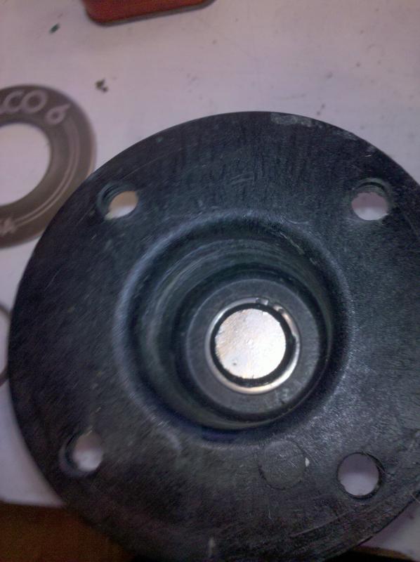

Here are the photos from one of my rebuilds
Here are the photos I took from my rebuild. Hopefully this will give you an idea of what is involved. The body is freed by removing a spiral clip that I took off with a pair of small flat blade screw drivers. By removing the winch from the boat, I was able to remove the cir-clip that holds the shaft on the upper casting and clean it and grease before re assembly. The pawls and springs just slip out from above and I soaked them in solvent to clean them. The rest I cleaned with a toothbrush and some solvent. I was very sparing with the grease and used oil on the pawls. Its been about a year and a half and they are still working well. I will likely tear one down in another 6 months to a year and see how they are holding up. You know, after I run out of other things to do, lol...
