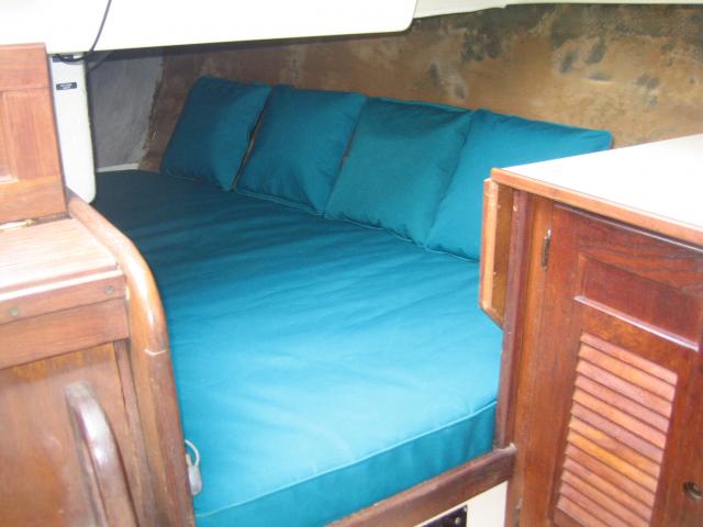

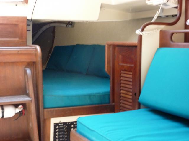

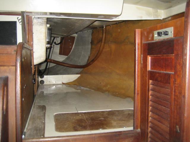

There is a space under the quarter berth after the battery compartment that can be opened for storage. I removed the stern wall and non working refrig unit, removed the carpet and foam and glued up wall liner to the quarter berth. I have considered opening up the area under for extra storage but have not done so yet. The pic show different stages of progress over the years.
I have also done many improvements and upgrades also. If you have any other ideas or questions feel free to ask.

If you notice in the above pics I also trimmed off the 3 1/2" fiberglass headliner flange that use to hang down over the quarter berth entrance. This makes access much easier and does not adversely affect the port stern interior cabin wall in any way. It makes the quarter berth feel more inviting , spacious and less confining
