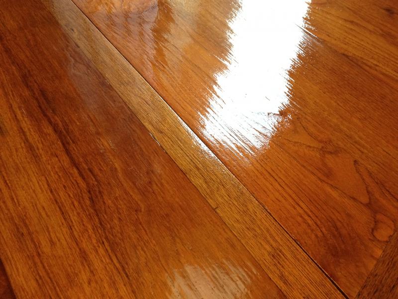

Cetol Natural - 4 coats
Cetol Gloss - 3 Coats
i can't think of a single varnish that looks better than this..
