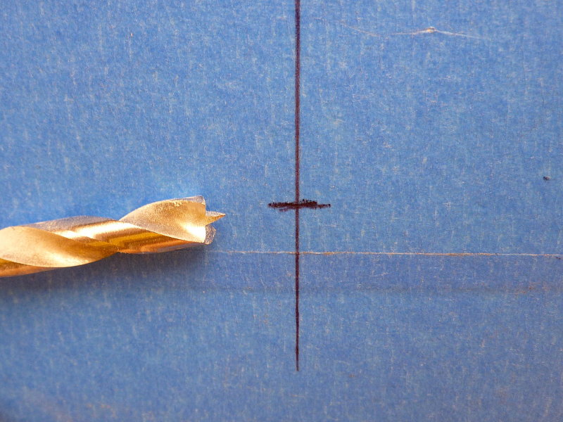

You want either brad point bits, started in reverse, or a 1/2" hole saw, also started in reverse but only AFTER drilling the pilot hole.

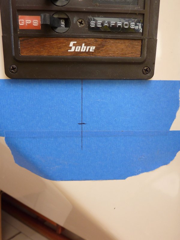

A while ago while installing a battery monitor on a customers boat I remembered to take some pics. Measuring for it took far longer than the act of drilling..
The only reason for tape was to mark my hole center and I get holes just as clean without tape:

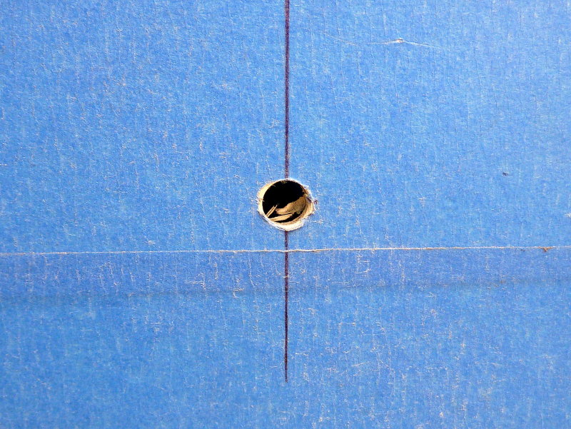

I then pre-drilled a 1/4" pilot hole, the same size as my hole saws arbor drill, using a brad point drill bit starting out in reverse to get through the gelcoat:
Started in reverse with the brad point and once through the gelcoat I switch to forward:

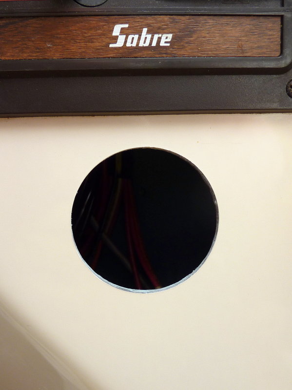

Then I busted out one of my trusty Lennox hole saws and drilled through about half way in reverse before switching to forward:
Hole done, no chips and perfectly clean:

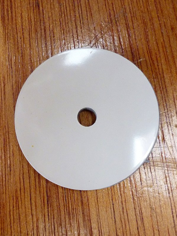

Just for you guys I saved the plug to show how easy this is;):
The right tools and the right technique make for easy work..:D
