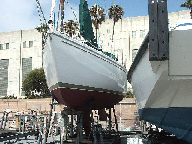

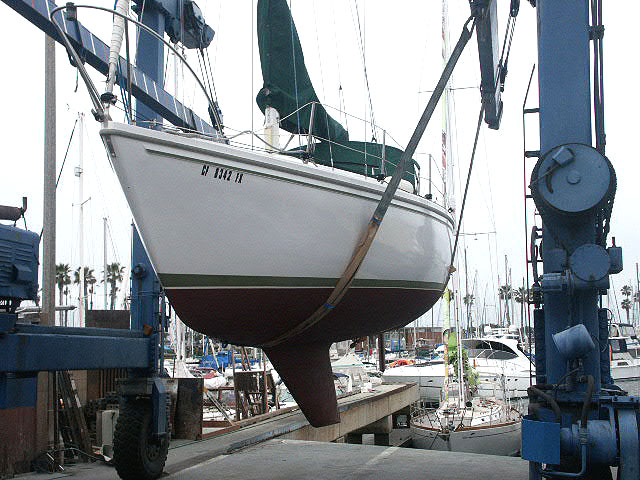

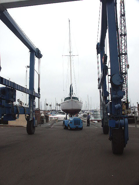

I realize it's a little far to go for a bottom job but for comparison King Harbor Marine Center in Redondo Beach (L.A. area) charges $750 for travelift round trip, pressure wash the bottom and a single coat of Trinidad for a 30' sailboat. Extra coats are extra $$.
Their travelift is in good shape, you can do your own work if you prefer, drive right into the yard with your vehicle and park in front of your boat. They even provided me a yard key so I could work before or after hours. If they're doing work on the boat, lay days are free, otherwise lay days are $3/foot/day. There is a $50/gallon surcharge if you bring in your own bottom paint.
My recent haulout in July was from Friday to Tuesday. For the work I did, I prepped and painted 2 coats of topsides paint, replaced 2 thru-hulls, prepped and painted 2 coats of my own Trinidad. The work the yard did was 1 coat of Trinidad. Total yard bill was $836 for my Catalina 30. I was very happy, great haulout for a reasonable price.
