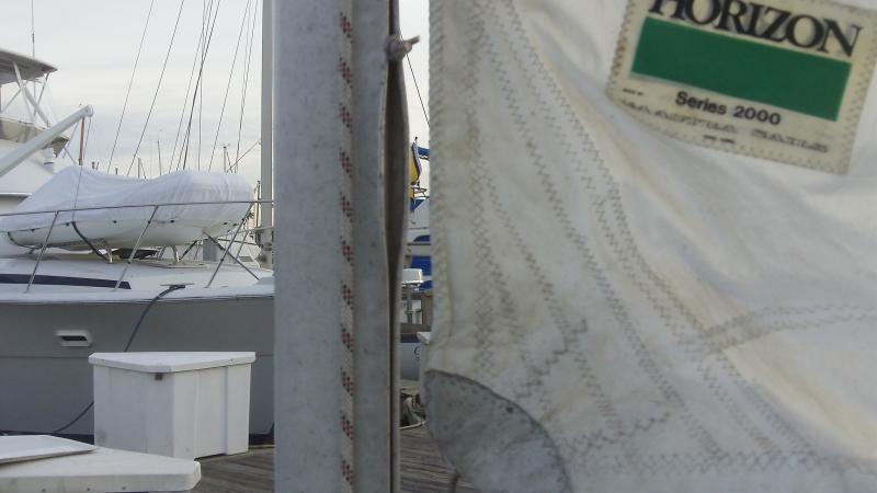

the rope in my main sail (in the bottom section of the luff) has shrunk thus the tack area is kind of baggy, see pic. I already removed some of the thread that attached the sail to the rope but that didn't help much, anything else I can do?

Those creases behind the reinforcement patches are called 'girts' and usually indicate that the sail has not been properly RAISED, ... and probably also with insufficient outhaul tension.
In your pic, the luff section, parallel to the mast, also seems 'wavy', also indicating that you are not fully raising this sail and applying proper tension to the luff by the halyard.
With woven dacron sails with 'boltropes' (a three strand rope inside a sleeve at the luff) you cant simply raise such a sail to 'just up'; you have to 'stretch out' those bolt-ropes or the sail will be quite misshapen, baggy, etc. The following URL will explain how to properly raise a bolt-roped dacron sail.
Your sail dimensions are listed below and for YOUR boat, you will have to add ~2" extra stretch to the luff and ~1" extra stretch to the foot. Just use 90° as your 'as raised' benchmark 'tack angle' --- just use a perfectly square piece of cardboard to verify the 'properly raised' sail's tack angle after applying that extra halyard tension.

If your mainsail is still in good condition, take it to any qualified sail loft and have them reset the bolt rope -- a relatively easy and inexpensive chore for them.

You can 'worry' the halyard:
Prep -
Put a mark (tape, etc.) on the mast next to where the halyard will be when tightened ... somewhere near 'eye level'.
Raise the sail to 'just up' and put a mark (tape, etc.) on the halyard ~2 inches above where the mark is on the mast.
'Worrying':
• Pull the halyard so that the sail is just 'up'
• Put a half turn around your halyard cleat with the halyard.
• Pull a bit of tension on the bitter end or free end of the halyard so that there will be some 'friction' of the halyard on its cleat to prevent the half turn from slipping.
• Pull perpendicularly on the halyard - away from the mast (imagine pulling a 'bow string') ... the 'pull' will be parallel to the horizontal ... as you hold 'friction' onto the cleat with your 'other hand' so that the bitter end doesnt slip when you pull perpendicularly on the halyard.
• Hold that increased tension on the halyard as you bring it back to the mast and tighten (shorten) the bitter end thats halfway around the cleat.
• Repeat as necessary until both marks 'line up'.
Note - pulling on the line 'perpendicularly' will cause approximately TEN TIMES the force 'along' the halyard that you cause by pulling it 'perpendicularly' ... for 'small' increments (no more than 2 ft. for your ~20ft. luff) of 'sideways' pull that you put into the halyard.
Then follow the directions in that 'properly raising' posting to find the 'sweet spot' of proper halyard (when sailing in your 'normal' wind strength) strain so your boat s-l-o-w-ly heads up when you let go of the tiller/wheel, etc. .. and then change one of the marks, on mast or halyard, for the approx. tension that gives you 'the best' weather helm ... where the boat on a beat 's-l-o-w-l-y heads up when you let go of the tiller/wheel. This will give you a close return reference to the exact same hayard tension each time you go sailing in 'similar' wind and wave conditions.
Doing such 'halyard strain' will properly 'shift' the point of where maximum draft - POMD occurs (forwards or aft) in a dacron cross-cut sail ... and which is responsible for 99% of 'weather helm'.
