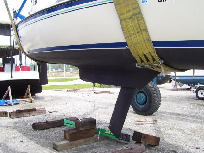

Is the bottom of your boat clean? (looks great in the photo - is it like that now?) Is your centerboard shaped for hydrodynamic efficiency (reasonable lift without lots of drag)? The board in the photo is squared off on the bottom, though it hangs at an angle. That means the bottom 10 to 12 inches don't do much for lift, and cetainly create drag and turbulence. Are you actually hurting yourself by trying to point too high? - if you pinch the boat, the lessened speed will cost lift to windward (board not moving as fast through the water), thus hurting you two ways. Certainly a decent 27-foot anything should outsail your 222, and that particular one handicaps about a half-minute a mile faster than your boat - that's not a fair comparison. He should eat you alive with his taller mast, greater sail area, and waterline. Are you trimming sails efficiently for the conditions? Your boat is a trailer sailer, with everything that implies, while the Tartan does not make those compromises.
