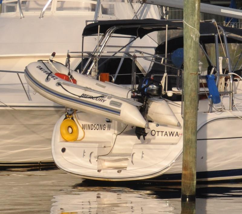

We have a dinghy on davits on our H356. We used to own a bigger dinghy (9'10"), we found it was too heavy for me to lift and move around alone, about 100 lbs. We now use a smaller one (8'10") at about 70 lbs I find it manageable with my back. The bigger one was easier to plane. We use a 6hp outboard. Both are hypalon with air deck. Our davits have a 6:1 tackle on one end to lift the dinghy with outboard on it. I also use the davit to lift the outboard on and off the dinghy by myself.
The smaller dinghy is fine for two of us and our small dog. If we wanted to use it 4 adults I would own the bigger size.
Check with the manufacturer of your davits for how much weight they can support. The dinghy must be very solidly held to avoid wearing a hole in the fabric or shock loading the davits when dropping off a wave. I use a couple of ratchet straps to snug it down so it can not move a mm.
Be sure to leave the drain plug out and transom down in case of rain when away from the boat.
Bob
