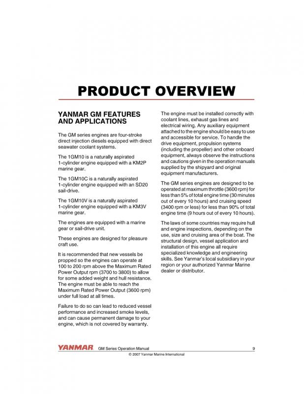

Newbie. Hunter 27. Yanmar 1GM.
What RPM do you run for "general cruising" ?
Looking at my manual, below, looks like 3,400 ? Sounds high - I've been running at 2,200.
Appreciate any insight. Thanks !

First thing to do is to check your tachometer .(Use a digital sort of like this http://www.harborfreight.com/digital-photo-sensor-tachometer-66632.html .) The Yanmar supplied tachometers are notoriously geframitzed.. Then once you know what the tach means when it reads a number, use 2400-3000 (real RPM) or someplace in there to keep it happy.. Find a sweet spot and use it.. Too slow and you'll carbon up the elbow

On the top of you engine is a plate. It will indicate what your continuous and maximum RPMS should be. If it says your continuous is 3400 then you can run 3400. The Yanmar rep said you should run at or near your continuous rating as much as possible. Now, your fuel economy will be less at the continuous rating so you might run at lower speeds at times if you are interested in economy. Frankly most people run their engines too slow. If in doubt call a Yanmar engine representative.

If you are not getting the proper speed at the recommended RPM's you may need to have your prop checked. We have heard many complaints about lower speeds and it is usually an incorrect prop, assuming your engine is operating properly.
