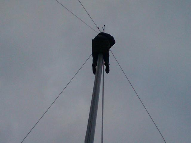

The next day my wife and I went down to tackle the problem. I pulled her up to the spreaders in the chair and discovered that the wire halyard had twisted around the head of the foil and the cable down to the head of the sail had become lodged INSIDE the foil. There was no way to pull the sail down. She tried using a boat hook to grap a bit of the cable and pull but it was in there but good.
She (I) decided to go (let her go) to the top of the mast and attach a shackle on the cable with a rope down to me and I would pull the shackle down to the head of the sail pulling the cable out of the foil as I went.

To make matters worse, while I pulled my wife up to the top, the wire to rope transition got all twisted on the winch I couldn't ease it back and I was afraid to poke and prod at the mess for fear of cutting the rope end or snapping the wire and sending her plummeting 40 feet down.

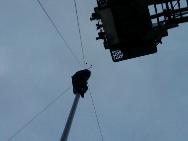

I called 911 and attempted to explain to the dispatcher what I did. A first for him. 5 minutes later 2 fire trucks, a hook and ladder and about 30 volunteer firemen were at the scene. They saved my wife from certain death and hopefully the rescuers got their 'save'!!! My wife was a great sport about it.

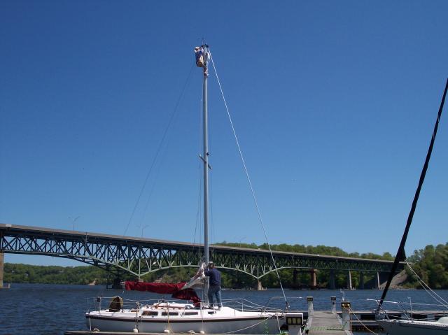

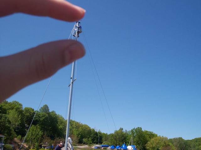

My wife went back up the mast and this time my son helped to make sure the cable and rope didn't bind on each other. She threaded the new line though the mast head, I cut the cable down below and voila! I had an all rope halyard for the jib! Just what I wanted.

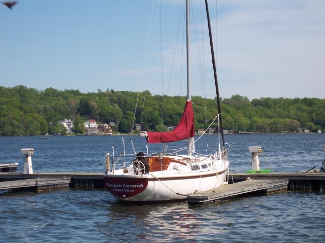

I pulled the sail up the foil, got it within the requisite 4-6" from the top and had the furler charged the right way. I was on the water sailing 45 minutes later on her first shake down cruise of the season. No problems.
