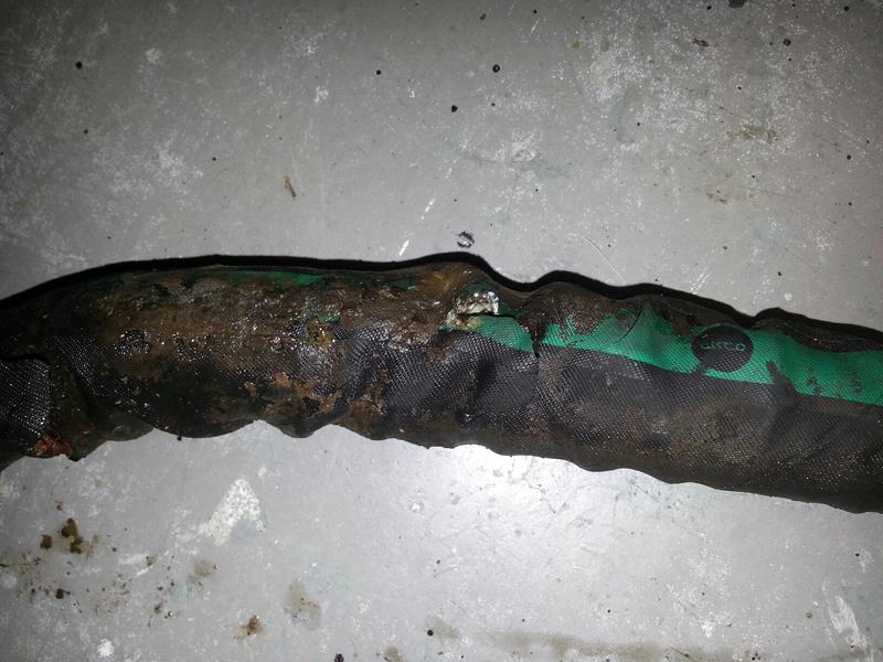

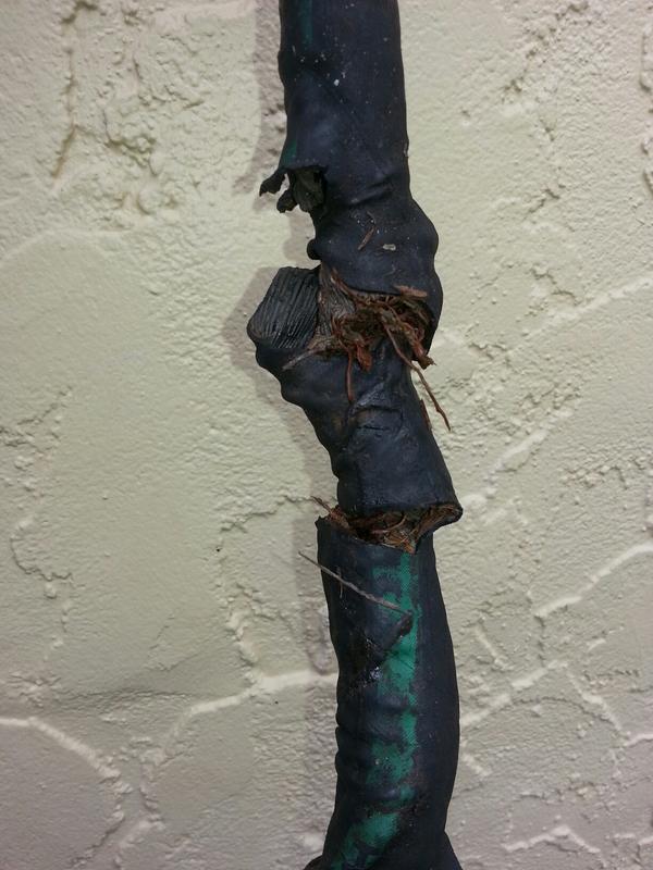

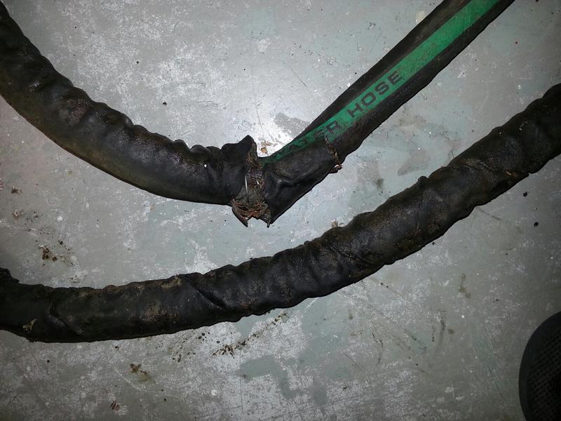

I recently found a leak in the engine coolant hose that heated the water heater. I caught it early when there was just a pin hole leak. Today I replaced the hose and much to my surprise the section of the hose that laid hidden under the sole had severely deteriorated. As you can see I had a picture I took from inside one of the stringers. When I saw that, I vacuumed and cleaned the mess out but didn't catch the deteriorating water hose which is visible
The drain holes in the H34 really do not provide adequate drainage. Is there a reason the drain holes were drilled so high?
I guess my point is that it might be wise to check what lurks beneath.

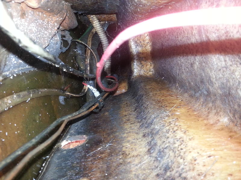

Good info Jon. Something else I need to look at. Is the last picture in the liner by the bilge pan? I see the brown wire that usually feeds a bilge pump. There seems to be a lot of other wires there too that I don't recognize. Maybe the bonding wire from the mast and keel bolts?

Given the age of your boat you are lucky that more of the old coolant hoses are not leaking and seeping.
**It's Past time to replace them all.
I helped a friend rerun some new hoses in a Hunter 31 of that vintage. We both had a lot of cuts from trying work around all the bored-out access holes left un-champhered by the builders. We did a lot of hand sanding and grinding to smooth up all the access holes with a Dremel tool.
If you get 20 leak-free years out of those hoses, you're are doing fine!

Allan... Looking athwartship to starboard in the stringer that runs from under the navigation desk. The hoses are running from the engine on right (picture may need rotating) to the water heater under the aft dinette settee. The Red is the main to the panel. The both brown wires is to the bilge pump. There is also 2 120 lines that runs to the A/C and the water heater... I have to thell you that I'm not certain what the black one is... However, I should know this soon since I will be replacing the bilge lines.

I can see the white hose that I believe is the ice box drain headed towards the bilge. That is the only area I enlarged. You may have seen the discussion about cutting out the bottom of the sump (pan liner) so that the bilge pump is directly on the hull and there is no water trapped in between to slosh around and get stinky. Your photo somewhat illustrates that happened in the past as it looks kind of contaminated on the wires and hose from previous nasty water. It looks dry now fortunately. I can see that open hole in your picture which I think goes into the engine bay. Then I see the heater hoses for the water heater also of course penetrating the engine bay. I keep a rag stuffed in those as I don't want oil or diesel (should there be a leak) from getting under there as it will be really hard to clean out. I also keep absorbent pillows pushed right against the front of the engine bay as a de facto filter in case of an organic spill.
If the red wire is to the electrical panel, then I will guess that the black is the electrical panel ground. I thought my AC to the outlets on the starboard side was run forward and then through the beam over the compression post. I'll have to check on that one. I can understand the water heater AC routing that way.
